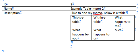

    I'll answer the second question first because it's quicker; if you import individual tables in a doc as individual items, images in that doc will be imported into Jama and stored on the server. They will display in the Jama item as they do in Word.
    Provided you follow the instructions for each table being an individual item (this">https://community.jamasoftware.com/jama/topics/how-various-word-layouts-will-look-when-imported-into-jama">this article provides the most context), you can import a "nested table." Treating each table as an item really applies to the outermost table, because you are mapping each leftmost column to corresponding Jama fields.
    So a word doc with a table like this:
    https://d2r1vs3d9006ap.cloudfront.net/s3_images/1504740/11841-l6ypnr_inline.png?1478102663" />
    will import like this:

    Your image and description is exactly how my requirement table is setup.  The import implementation is perfect because the nested table is part of the requirement description and not a separate requirement.
