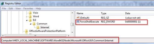

    I've duplicated your problem. Below is the work-around involving hacking the Windows registry.
     I'm going to hope that @Kristina with Jama will help us to see if there is a better server-side fix.
    Problems:
    1) hosted 2015.1 works fine.
    2) on-premises 2014 fall release works fine
    3) on-premises 2015.1
            an example is =HYPERLINK("https://SERVERNAME/contour/perspective.req?projectId=223&docId=3152200","ITEM_ID")
      On Win7
            if pasted in Outlook, will open
            if pasted in Word or Excel, will fail
                   failed in Chrome, FireFox, Internet Explorer 8
    Very strange. I have doubled checked my Excel trust center settings. All very open.
    I am not sure whether it's our servers security/encryption settings.....
    Just found and reading this article: https://hampelgroup.com/unable-to-open-url-cannot-download-the-information-you-requested-error-in-wo...
    I have confirmed this fix.
    https://support.microsoft.com/en-us/kb/218153
    To work around this issue, either add the ForceShellExecute subkey, if it is not present, and set the Valuedata, or if it is present, set the Value data of the ForceShellExecute subkey.Adding the Internet Subkey to the Registry and Setting the Value Data
    1. Quit any programs that are running.
    2. Click Start, and then click Run. Type regedit in the Open box, and then click OK.
    3. In Registry Editor, browse to one of the following subkey (create the keys when they do not exist):For a 32 Bit version of Office on 64 bit version of Windows
      HKLM\SOFTWARE\Wow6432Node\Microsoft\Office\9.0\Common\Internet\
      For a 32 Bit version of Office on 32 bit version of Windows
      HKEY_LOCAL_MACHINE\SOFTWARE\Microsoft\Office\9.0\Common\Internet
      For a 64 Bit version of Office on 64 bit version of Windows
    4. Make sure the Internet subkey is selected. On the Edit menu, point to New, and then clickDWORD Value. Add the following registry value:Value Name: ForceShellExecute
    5. Double-click ForceShellExecute, and then set the Value data to 1. Click OK.
    6. On the Registry menu, click Exit.
    You don't have to re-boot. Be sure to exit Excel and re-open Excel. Let us know if this work for you.

    I have just tested the workaround suggested by him and it solved the problem. I've read that this registry entry has other implications (http://blogs.technet.com/b/emeaoffice/archive/2013/06/13/impact-of-using-forceshellexecute-1-in-offi...), but I think they won't be a problem for us.
    It's been rare that even though I have Office 2007 (v12.0) installed, the registry value has to be added to this location: HKLM\SOFTWARE\Wow6432Node\Microsoft\Office\9.0\Common\Internet\...

    Glad that the work-around works for you. On my own system I also have to create the 9.0 subkey.

    Hi Robert,
    I think if you create '9.0' in the registry, the fix should work - see Lisandro's comment from above "It's been rare that even though I have Office 2007 (v12.0) installed, the registry value has to be added to this location: HKLM\SOFTWARE\Wow6432Node\Microsoft\Office\9.0\Common\Internet\...".
    I am running Windows 7 64bit with Office 2013 and it worked for me. However, I reverted back due to the subtle changes in how Office then opens links. http://blogs.technet.com/b/emeaoffice/archive/2013/06/13/impact-of-using-forceshellexecute-1-in-offi...">http://blogs.technet.com/b/emeaoffice/archive/2013/06/13/impact-of-using-forceshellexecute-1-in-office-2007-2010-and-2013.aspx">http://blogs.technet.com/b/emeaoffice/archive/2013/06/13/impact-of-using-forceshellexecute-1-in-offi...
    Regards,
    Stephen

    Oh no! Thanks for letting me know, Sebastian. I'm updating the bug with all this info so we can decide what to do next.
  • 32.  Re: Hyperlinks in exported documents don't work (SOS-BUG-829)
    Posted 04-12-2016 22:46
    Stephen, are you saying that while the workaround of editing the registry works, it might not be preferable because the links then open differently?

    I'm glad to hear the workaround worked!
  • 37.  Re: Hyperlinks in exported documents don't work (SOS-BUG-829)
    Posted 04-20-2016 07:26
    Yeah Kristina - looking at how it impacts the way Office opens docs, I reverted back.  Probably wouldn't have been too much of an issue but I'm happy to copy paste urls until this is resolved.  Others have made the reg edit and aren't complaining about an impact on using the standard Office tools.
