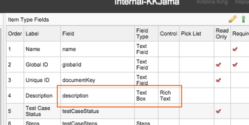

    Just an idea, but have you tried to add a new item type and duplicate the fields of your item type "Defect". May be, it's an inconsistency in the database which only affects that item type. You may add an item type "Issue" and you this for a while.
    Best regards,
    Sebastian

    Hi Sebastian,
    Thanks for the idea, but I've observed this problem on both hosted sandbox and on-premises 2015.1 on several item types. As long as the item type has at least one rich text field, then this problem will intermittently happen to me 3-10 times a day. I have to close the browser, work a while, but then the problem will come back. Somehow the rich text ckeditor is somehow not active for some cases and will hang the whole Jama web UI. Hopefully Jama will eventually figure out how to fix to problem.

    Hi Stephen, that workaround might not work for you. But it might work for Ian...

    Hi Sebastian, let's hope something does work for Ian. He is very frustrated. I can totally understand. I think this is not a data source problem. Seems like a client interaction with the ckeditor rich text editor. There are a slew of Google threads that deal with ckeditor ready status. Kristina also said that there seems to be only one known work-around involving not having the browser cookies save authentication info. I'm trying that work-around currently. swoo

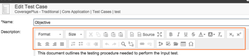

    This reply was created from a merged topic originally titled I am using Chrome and I am consistently getting no Description selection when I t....
    I am using Chrome and I am consistently getting no Description selection when I try to edit an object.
    Here is a screen shot.
    When I try to cancel the edit, it has the following message:
    I have tried this in Internet Explorer and it seems to work fine.
    What would be the problem with Chrome that is not happening in Internet Explorer?

    Posted 09-30-2015 12:46
    Tim, if you have admin rights, you can tell if a field is rich text via Admin > Item Types > [Item Type in question] > Config. If the Control field is "Rich Text," you might run into this problem.
    https://d2r1vs3d9006ap.cloudfront.net/s3_images/1285490/13026-1vwffi5_inline.png?1443627565" />
    You can also tell a field is in rich text while you're in Edit mode while viewing the item, because the Rich Text tools will be available. https://d2r1vs3d9006ap.cloudfront.net/s3_images/1285491/13026-lmjq6n_inline.png?1443627606" />
    Plain text fields will not have this toolbar. Nothing "force" field data into rich text—it's determined by the item type configuration in Admin. So even if you simply import plain text data from Excel into this Description field, it would be rich text without any additional changes by you.
    As far as avoiding this goes, it's a bug that we need to fix. However, we have found that if users do not check the "Remember Me" option on the Jama login screen, they do not encounter this error (or it stops happening). I recommend all users log out of Jama, uncheck "Remember Me" and sign back in. Unfortunately this means your users will have to sign in after a session timeout, but this error should stop occurring.
