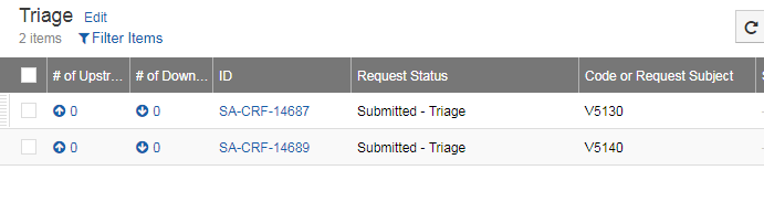

    Example 1: Relating 2 like items by opening item 1 > Click on Relationship widget > Click search > Search code > zero results
    step 1: No upsteam/downstream
    step1step 2: Search my second code "V5140" - returns zero results
    step2

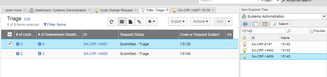

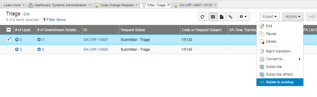

    Example 2: "Check-mark" item 1 within list view > Click Actions > "Relate to Existing" > Search Code > Returns results
    step 1
    step1astep 2: search code
    step2a

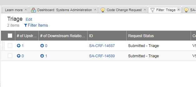

    step 3: relationship built
    step3

    This behavior is a known defect, SOS-DEF-2264: "Relate to Existing" from list/reading views allows one to break relationship rules. The correct behavior is what you see in Single Item View, so we suggest mentioning to your users to relate items from Single Item View.
    I went ahead and related your Organization and this post to SOS-DEF-2264 in our internal tracking system. When reviewing the Release Notes, keep an eye out for this ID to know when it's been fixed.
