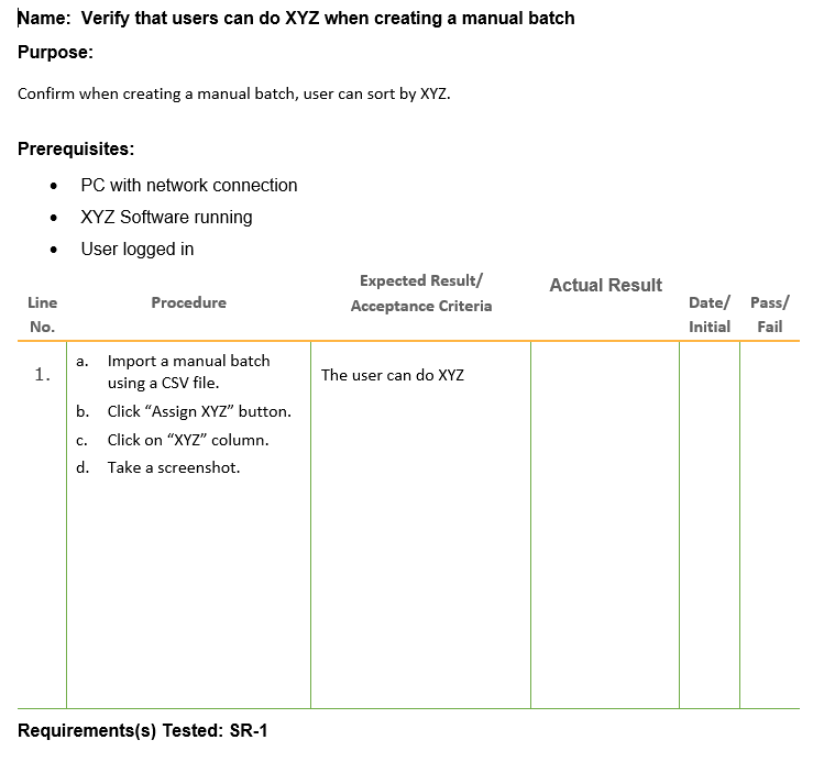

    Hello - I have a need to import legacy test cases (in the hundreds) that are currently in a Word document.  Truth be told, they were physical documents that were scanned in, PDF'd and then converted to Word.
    Is it remotely possible that I can format the document in such a way using styles that will allow Jama to understand how to map the fields correctly?  I've been working with it to no avail so I thought I'd check in with this group for guidance.
    Here is an example of each test case:
    Sample test case in Word
    Thank you!
    Vicki

    While testing in my instance, I made the assumption that you want to import these old test cases into a Jama Test Case item type and that you are wanting to map the Steps you have in your chart to our Test Steps within our Test Case? I realized I didn't ask....
    With this "assumption" in mind, I was not able to directly map the steps to the Test Steps field in the Test Case item type. I could import the whole item into the description and then I have to go back and copy paste the steps into the Steps fields. Like so:Our import wizard cannot directly map to "workflow fields" and the Test Center is pretty much complete with these type of fields, each one programmatically interconnected in some way.

    Yes, I wanted it imported into a test case.  I can't tell from your screenshot but can you confirm that you were able to get the Name and Description fields populated, where:
    Name = first line in import file
    Description = everything else
    Is this the case?  I'd like to know how you did this if so as it's better than nothing ;)
    However, ideally, we'd be able to port the table over to steps via the import process.  Do you suppose there's a way to convert the Word doc to Excel?  My understanding is that Excel is the preferred source file for importing.  Would you have any guidance in that regard?

    Yes, because you have the first line the way you do, this is how it uploads into an item with me doing nothing but the default upload. (I didn't do anything with the mapping - just pressed "next" "next" ....) see below:
    So you are set up really well with your headings if you just want the "Name:" and everything else in the "Description:" field. I will take a closer look at Excel and get back to you on this thread! Just wanted to get this information out to you.

    Thanks so much - you're right, I can use the formatting as is and just import the test cases.  This results in everything below the first line going into the description.
    I was initially going to ask you if there was a way to do ANY kind of updates to the Jama database/tables using SQL but I have a feeling I know what the answer is:  NO.   Correct?
