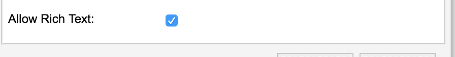

    I have already enabled the rich text of the Test steps of the Test Case Item

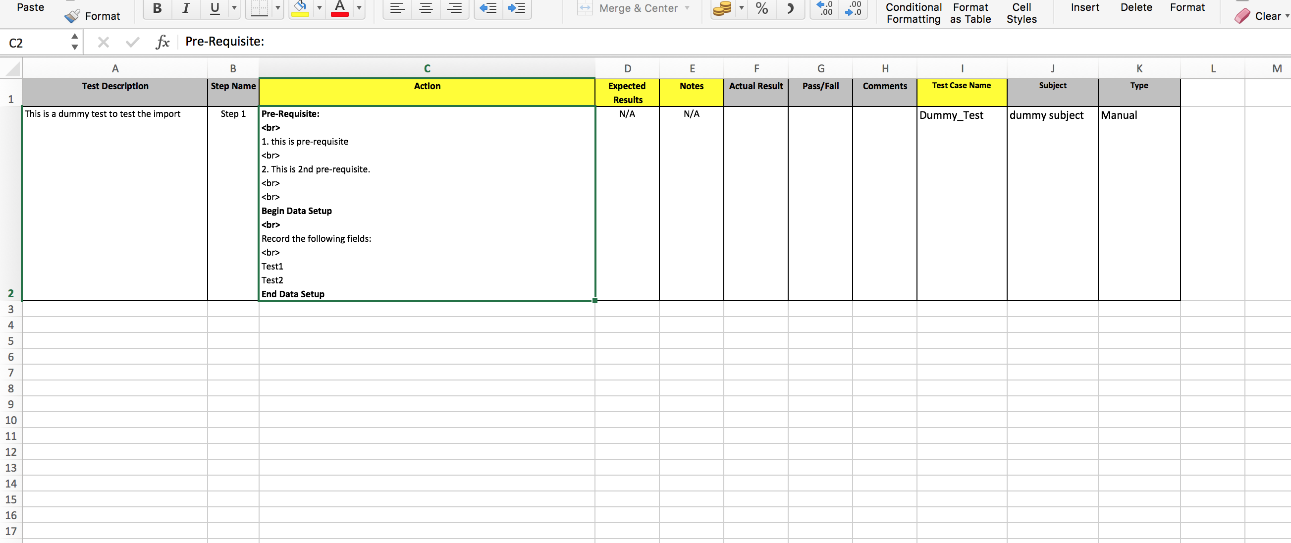

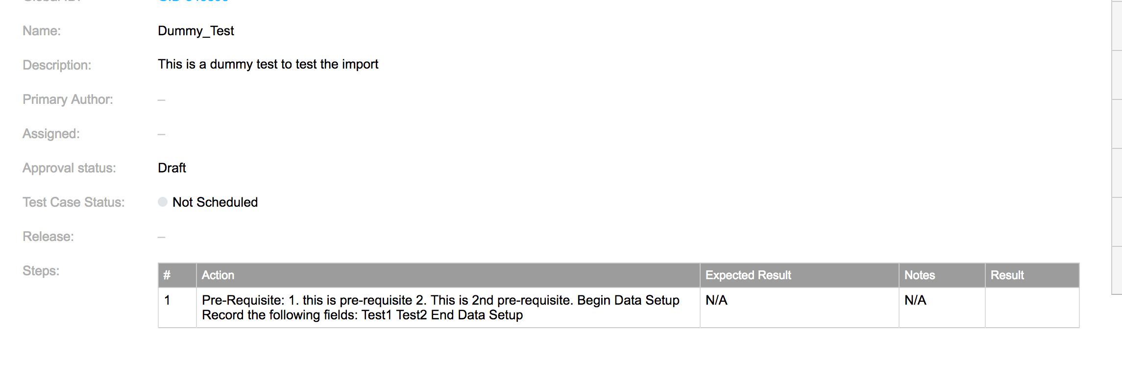

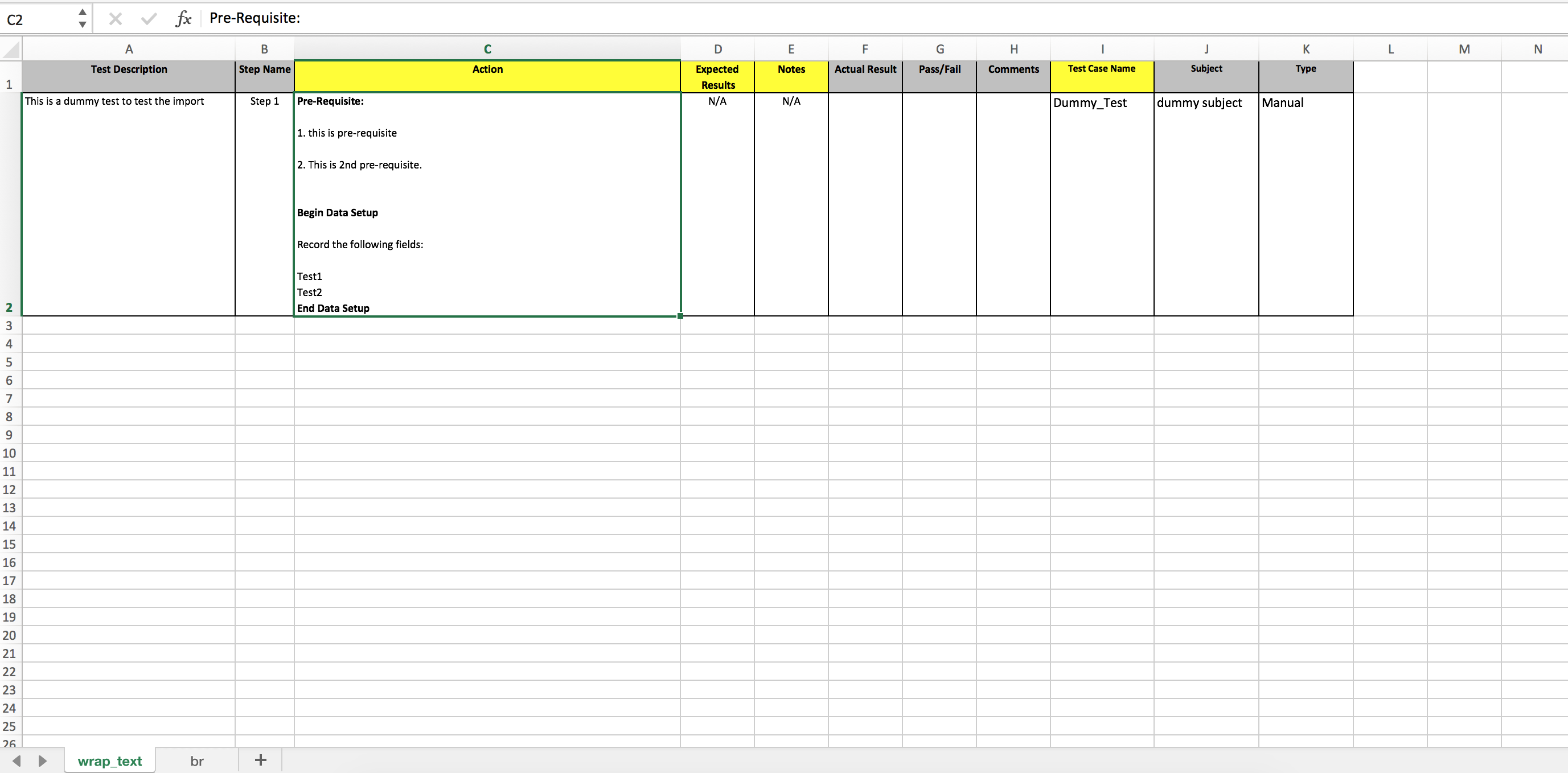

    The first sheet contains line break and here is the resulted import
    ​​while the second sheet, instead of using line break, i added html tag <br>, and here is the resulting import:
    In the second solution, it is working. so is the only way to solve this problem to substitute all the line breaks in the excel with the <br> ?
