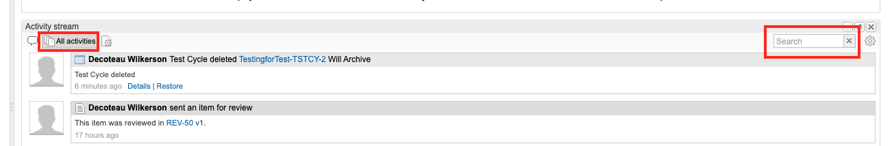

    Thank you for reaching out! If the Test Cycle was deleted, it should be noted in your Dashboard Activity Stream Widget.
    Make sure to select "All Activities" in the widget and search for terms like, "Delete", the user's name, "Test Cycle", etc.
    In the example below, I deleted a Test Cycle to show how its deletion would appear.
    Please let me know if that helps!

    I had to add the Activity Stream widget to the dashboard (someone had removed it) and after filtering on "Delete" it was the first thing in the list.  I was able to click on the "restore" option and it appears to have brought the cycle back.
