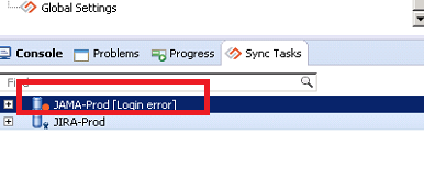

    Problem: i am able to login on Tasktop for jama server for sync, but after few hours automatically getting login error. I have attached screen shot of error.OEEP78LBSjqnRiQcsKfu_3.png

    Hi Kristina,
    Thanks for earlier. this is different issue. As i told earlier, we are able to login sync task on Tasktop server.
    But, after some time connection getting loss and getting below error.
    Because of this sync task is getting stop on Tasktop, we can not login server every time and enter password.
    Pravin

    this is really not a logon, its 'authnetication' (error 401).
    seems Jama checks the ldap server on EVERY api call..  altho nothing (roles, etc) are stored in LDAP

    Hi Sam,
    Thanks for earlier. We are able to login sync task on Tasktop server.
    But, after some time connection getting loss and getting given screen shot error.
    Because of this sync task is getting stop on Tasktop, we can not connect server every time and enter password fir authentication.
    Once it's authenticate it should store there.
    Pravin

    Yes, I understand.. my utilities are facing the same problem.
    This is an unfortunate side effect of a stateless/sessionless REST api.
    Each call is atomic, and the user must be authenticated each time..  this causes a message storm  (DoS attack) on the Authentication server.
