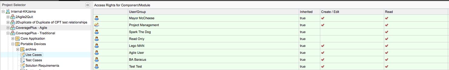

    *are these items being reused between two different projects?
    *do users have Create/Edit permissions in the whole destination project, or just the target container?
    -when you look at the Permissions assigned to this particular target project AND the container, are those permissions inherited? e.g. below they are all true:
