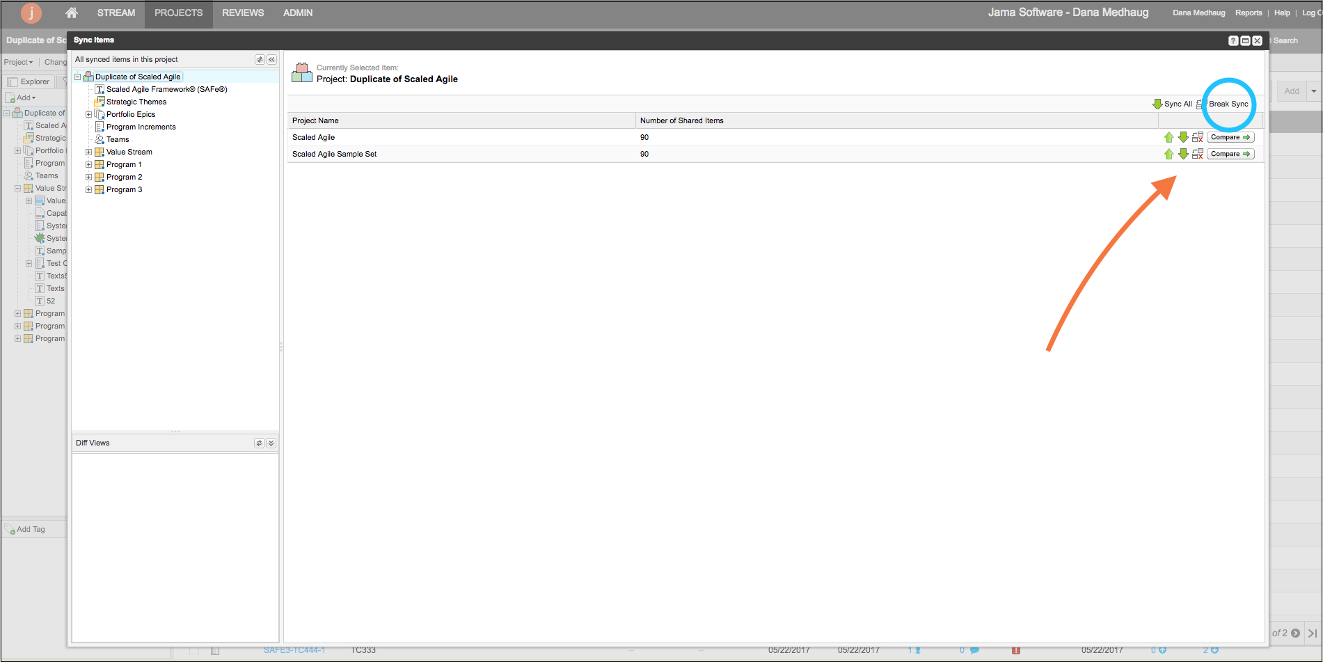

    It looks like all you need to do is right click on the project with the items you want to break sync with and click on view synced items. Select the items you want to break sync with and click the "Break Sync" option in the top right corner. I hope this solves your issue.
    To break sync, right click on the project in the explorer tree and select View Synced Items. Select Items > Break Sync.

    Thank you Dana.
    You pointed me to the right place.I did not know that it is in the project context menu.
