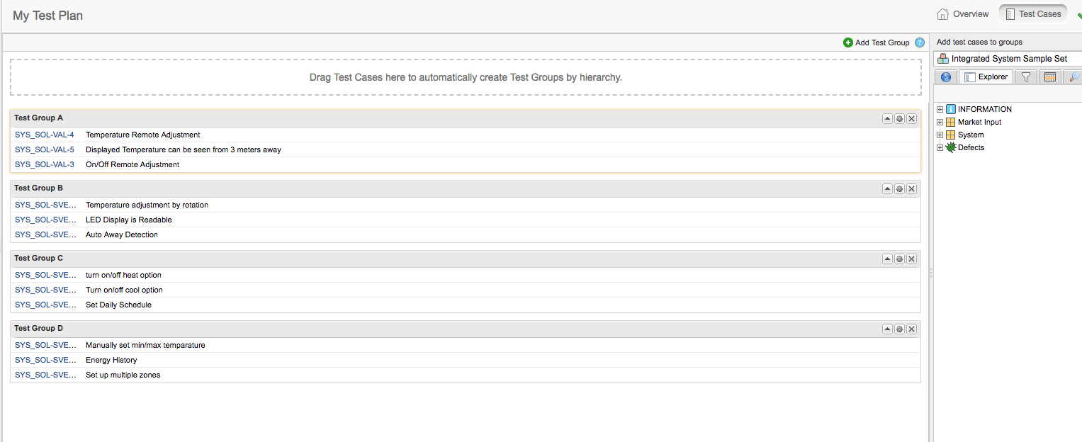

    I am not sure how you have your Test Plan organized but, I would suggest utilizing making Test Groups which you can assign Test Cases to like this:

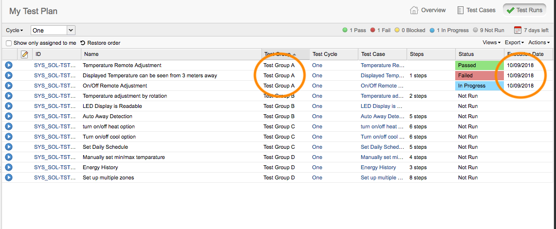

    Then you can click on the Test Run View and see the Execution date, and Status cross referenced with the Test group:
    You can configure the view under the Views>Configure View dropdown. Make sure Test Group, Status and Execution Date is in the view. Mari, do you think this could help?

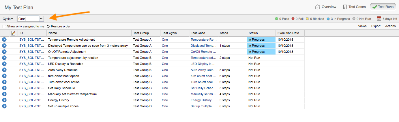

    So here I have Test Cycle "One":

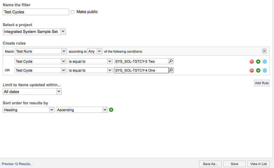

    Here is the Advanced Filter I did to capture the Test Runs in the Test Cycles I wanted to analyze:

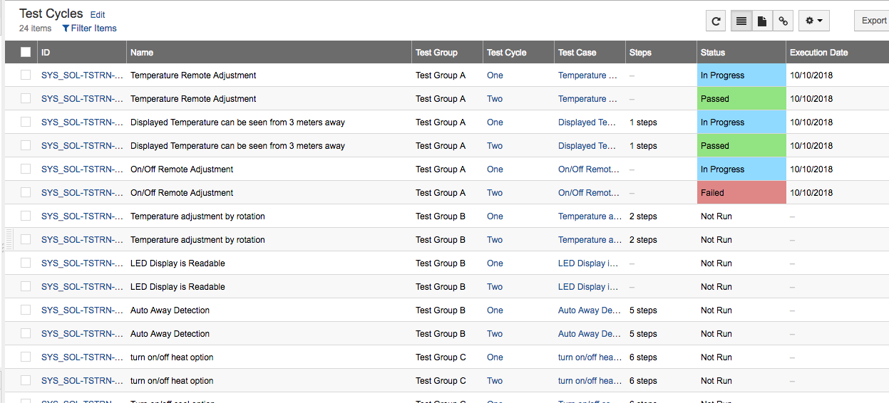

    And here are the sortable results:
    Mari: you could put these filter results in a Dashboard Widget to keep track. You would have to update the Filter to pull the current Test Cycles you are tracking. Hope this might be a better solution?
