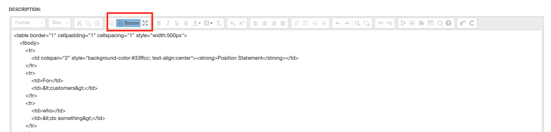

    What type of custom report is this? Also, how did you fill out those fields? Is there a chance the fields themselves have extra characters in them? This could be the case if their contents were either copy/pasted from somewhere else or imported from another document.
    Can you navigate to one of the fields showing extra returns and expose the source code? I am curious to know whether the fields themselves contain the extra information. Example:
  • 3.  RE: Random returns when exporting template
    Posted 07-01-2021 13:46
    Hi Decoteau,
    This is a custom word template export using mail merge fields using the code below.
    Here is the source code, I've looked to see if there are any extra characters but can't see any.
    Carter Morrill
