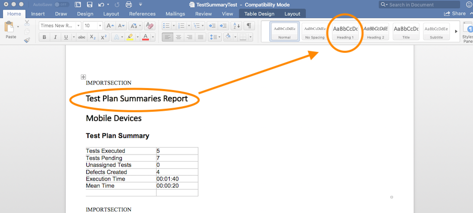

    Here is the Test Summary Report I downloaded from my sample set. I just downloaded it in Word and am now preparing it to re-import into Jama as its own item. To define the Scope of what you want to import using the Import Wizard, you will want to put these "IMPORTSECTION" around the charts or sections you want the import to recognize. It will ignore the parts not sandwiched by these tags.  I put in a title "Test Plan Summaries Report" and then changed the style to Heading 1. This tells Jama to put this in the name field of the item we will be creating. Not shown here, but I had three different charts to import, I went through and put the "IMPORTSECTION" tags around each of them.
    After you pick out which parts of the report you want to import into an item you will need to "Save" your word document and then it's Jama time!

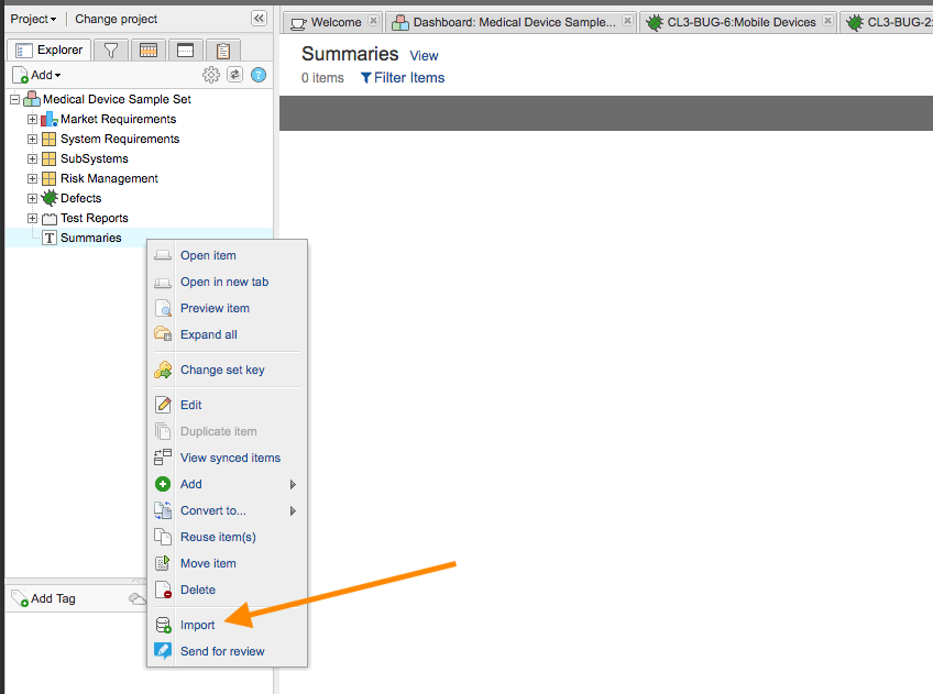

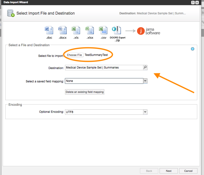

    In your Jama instance you are going to go into the Explorer Tree and create an item (needs to be a set) to import this item to. I just did a set of Text items and named it "Summaries". You will want to "right click" on the Set you are importing to and then click "import".

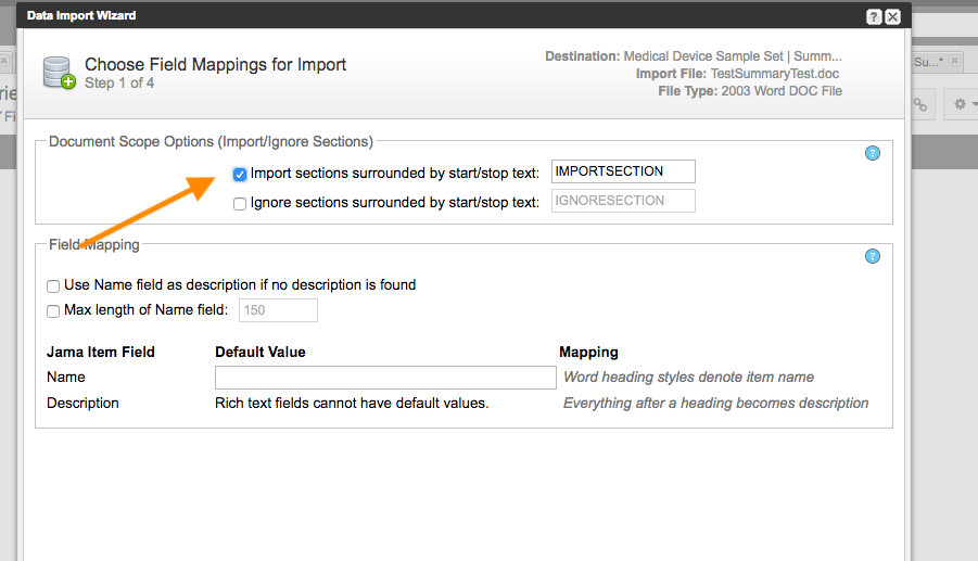

    The import wizard will pop up. Upload your "import ready" report. Make sure the destination is correct, and I choose "None" for mapping.
    Next page we are scoping this project with the "IMPORTSECTION" tags, check this box, hit next:

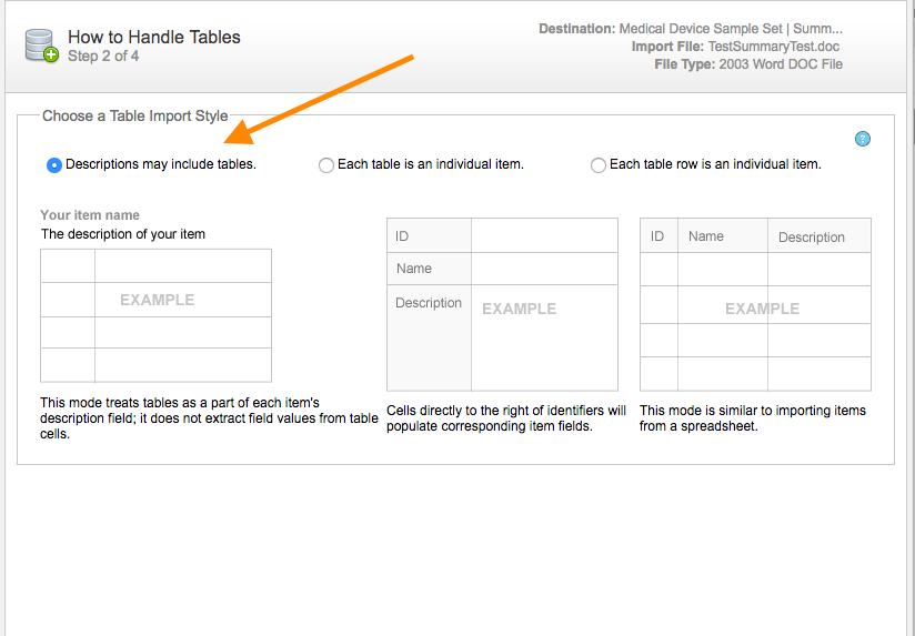

    Now are going to chose this first option, because we are scoping out the tables as being all in one item. Click next and in the next window, you should see a summary of your new item. Click "Submit".

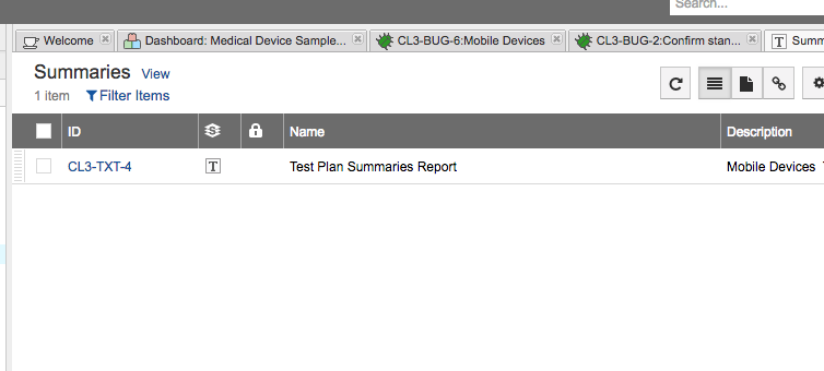

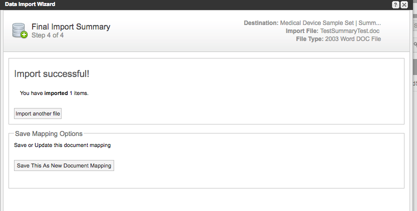

    You will know that your import is successful when you get this message and it tells you the amount of items you have imported. I imported 1 item!

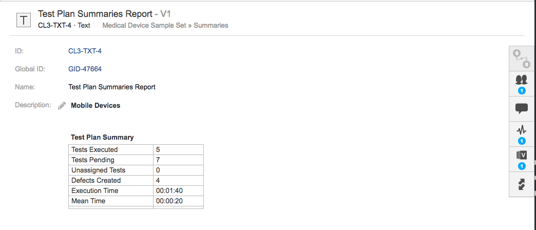

    You can now see the item, in the Set we created for it, here is the list view:
    Now you should be able to send this part of the report to Review.
