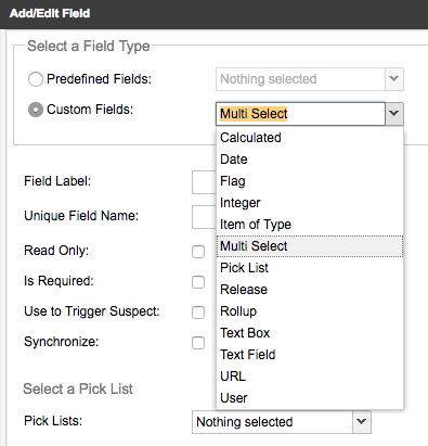

    Hi
    Is it possible in Jama to define a multi selection field?
    For example I currently have defined in a drop down Issue Type as
    SW
    HW
    SW / HW
    But this is difficult to extend
    Ideally I would like to show only SW and HW and for the user
    To be able to select either or both.
    Steven Hawkes
  • 2.  RE: Multiple Select Pick List
    Posted 08-07-2017 11:04
    Hi Steven,
    It is possible to define a Multi Select field, however, it is not possible to change your current field to a multi-select.
    When creating a new field, you would need to choose Multi Select, and then in the bottom indicate the pick list you want to use.
    If you want to convert the existing content of this field into a new multi-select field, you can use the workaround by Round-trip.
  • 3.  RE: Multiple Select Pick List
    Posted 08-08-2017 07:16
    That is what I needed.
    Thx
