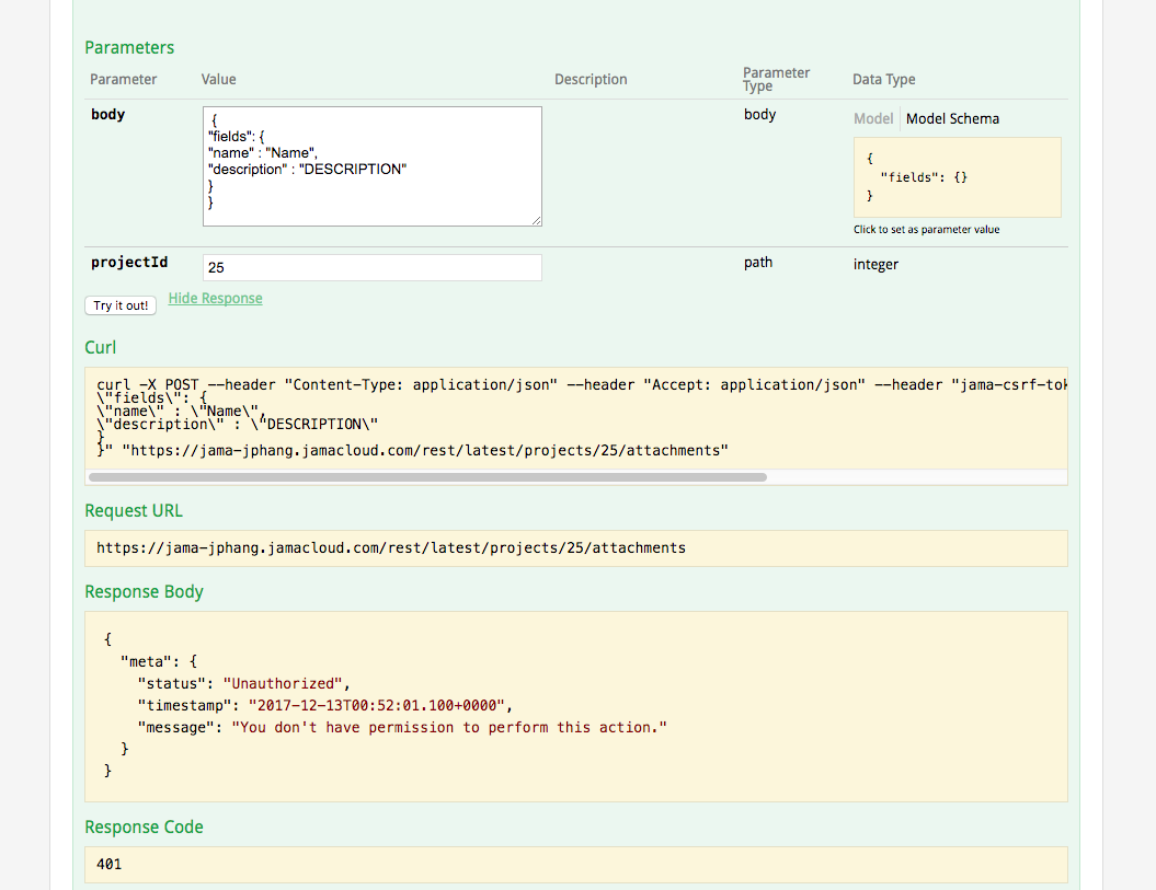

  • 5.  RE: Attachments not getting added to Jama
    Posted 12-12-2017 17:02
    This is the expected output for a user without permissions to the project that makes that request.
    Another possibility could be that there could be some odd hidden characters or curly quotes in the input response. Are other users experiencing this on your end, and is this the only problematic endpoint?
