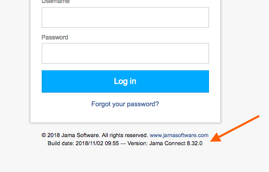

    If we are sending you a txt file, we may have in our records that the Jama Instance you are attempting to upgrade/renew is not Jama 8. Sounds like you are Airgapped and need to apply the file directly? If this is so, I would create a Support ticket to contact us with what your Jama version is, if it is currently Jama 8 then we will need to furnish you with the appropriate .rli file. You can find your version of Jama by logging out and then looking at the fine print under the password login panel.

    Hi Chloe,
    We are running JAMA 8 and you can see form the image here:
    Our license are expiring tomorrow and if you can look into it would be deeply appreciated.
