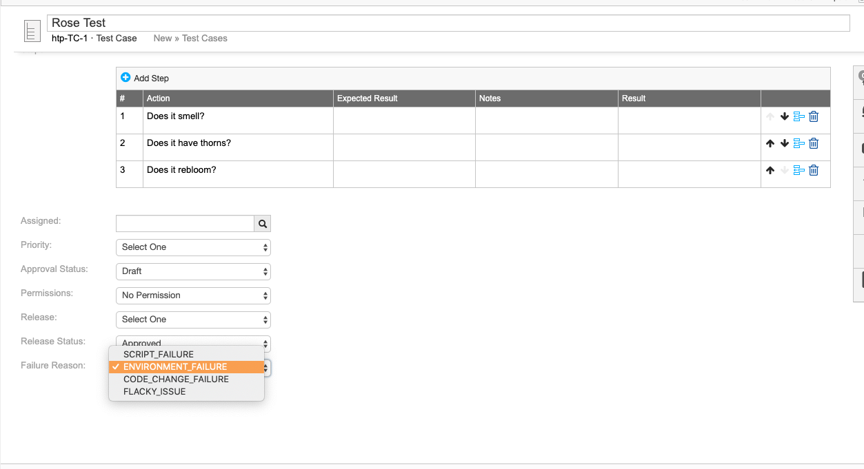

    ​Hello Team ,
    We want add some additional field values to test case status. What want specifically mention why this has failed
    For example:
    1. SCRIPT_FAILURE
    2. ENVIRONMENT_FAILURE
    3. CODE_CHANGE_FAILURE
    4. FLACKY_ISSUE
    Also we want generate dashboard using filters/widgets.
    Could you please add this feature of customization of field values to test case status.
    This will be more helpful/informative.

    You cannot add custom fields directly to the Test Case Status but, you can ask your Organizational Administrator to make a custom multi-select pick-list then add this custom pick-list to your Test Case item-type (or whichever item-type you are using as a Test Case).

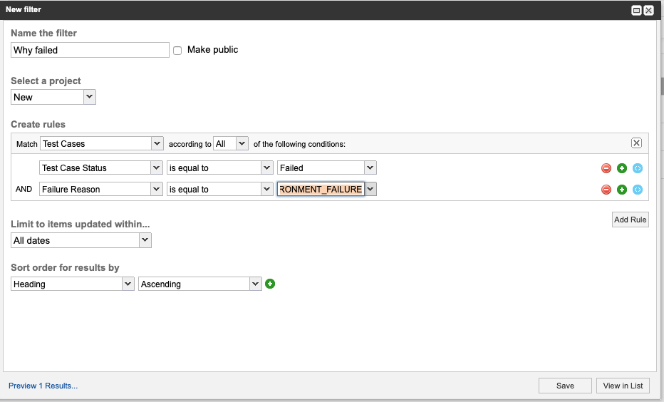

    This list will not inform the "status" and will only be available in the Test Case item but, you can use this to inform your team members and stakeholders "the reason" this particular test case failed. You can then use this same custom picklist in our Advanced Filters to find the exact Test Cases you need, like so:
    These Advanced Filters can then be sent to the Review Center or used to inform a dashboard widget within Jama (see the "Filter Results" widget).
