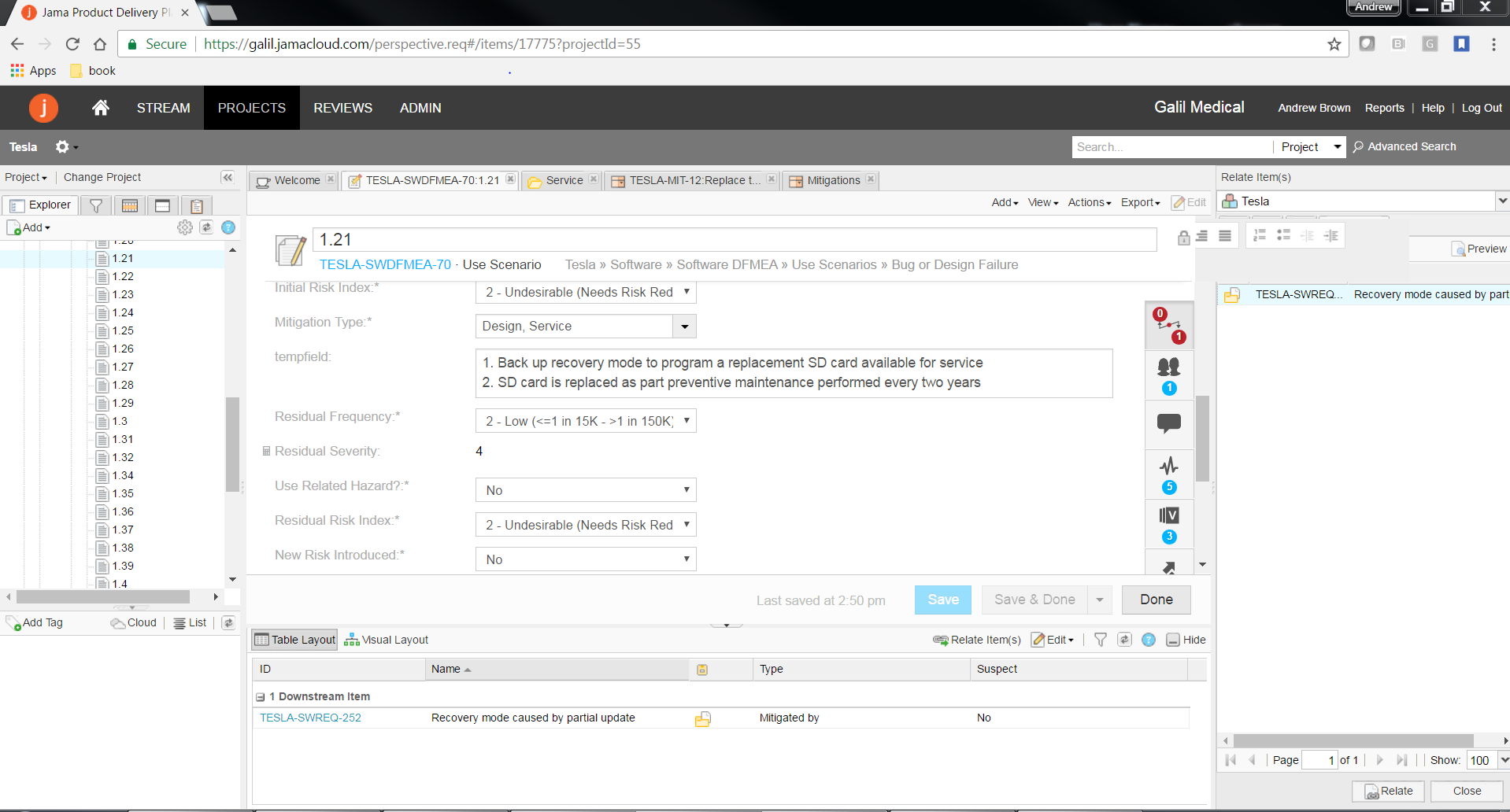

    The image below shows the relate window getting beat up by something else.  Chrome, Version 57.0.2987.110 (64-bit)
    Relate window UI bug

    Hi Andrew,
    I have filed a defect for this issue, SOS-DEF-1763. We just upgraded our rich text editor with this latest release (8.14), and it doesn't appear to dynamically resize the rich text editor's menu if you adjust the browser size. If you notice any other actions prompting this weird display issue, let me know—the only way I could find to replicate the problem was by narrowing the browser.

    Hi Andrew, hi Kristina,
    is it specific to only this version of Chrome?
    Im testing on 56.0.2924.87(32-bit) on Jama 8.14 Standard Channel and do not see any awkwardness.
    Or may be there is something specific in the steps. Shall one make any other actions after clicking the Relate Item(s) button?

    Ekaterina,
    The way I was able to reproduce this was by adjust the browser window size—if I narrowed it, the tool bar for the RTE would obscure whatever was to the right of it (so not necessarily just the Relate window).

    ok, thanks for details. I dont think this affects us.
