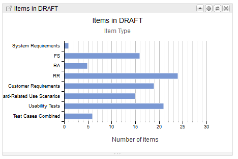

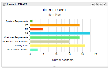

    Sure thing, Kimberly:
    Bar chart 8.25.1
    ...and this is the same diagram in 8.36.0:
    bar chart 8.36.0
    Anna Henke
    MeVis BreastCare GmbH & Co. KG

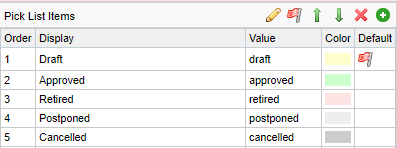

    I think I found the mechanic of when color coding is applied and when not in 8.36:

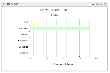

    If the field is based on a pick list and the values of the picklist have a color configured (Admin -> Pick Lists -> Values) then the color of that pick list value is used:
    Coloured pick list
    Bar chart with color

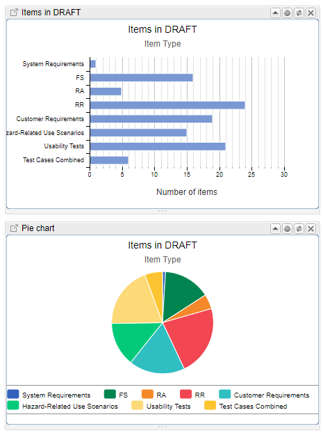

    If the field is not a pick list (like "Item Type" as in our example) a default color is used as well - but only for the Bar Chart. When configuring the same filter and field for a Pie Chart the color coding works again:
    Bar vs. Pie Chart
    I hope this clarifies the issue - it's not a big one, but has changed from 8.25 to 8.36.
