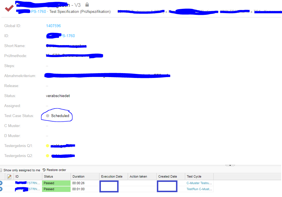

    We are using Jama 8.25.3.
    we have currently an issue with the Test Case Status of some test cases. All the associated Test runs of these Test Cases were executed with result – Passed (like in screenshot) but the Test Case Status shows as Scheduled. What could be the cause of these problems? How can we resolve this issue?

    Archive the testplan, then unarchive the testplan. Usually that helps.

    Hi Harald,
    Thanks for the hint. We'll try it.
    Question: When I archive a test plan and unarchive that, would Jama change any details of the testplan or test cycle or test run?

    Hi Lien,
    doing that the test case status get reprocessed, so if that was not inline with the testruns, this get repaired at that action, nothing else should happen to test cycles.
    regards
