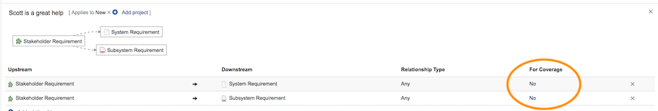

    1. When you are setting up your relationship rules you will want to configure the downstream items as "not for coverage" like so:
    In this example we have the item type Stakeholder Requirement with two downstream (optional) items: System Requirement and Subsystem Requirement.

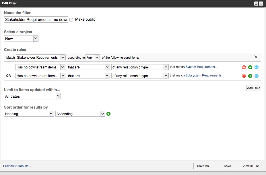

    2. Next we want to make the Advanced Filter to show us the Stakeholder Requirements who do NOT have any downstream relationships to either System Requirements or Subsystem Requirements:

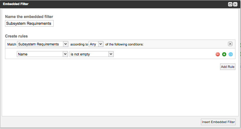

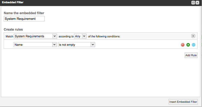

    the embedded filters will target the two downstream options:
    using the condition of "Name is not empty" works for pulling all the items of the type you are targeting because most likely, everything has a name.
    Same thing for the other embedded filter for the other item.
    Now we have a filter which will pull out all the System Requirements which do not have a downstream relationship with a Subsystem Requirement or a System Requirement. Name this filter and save.

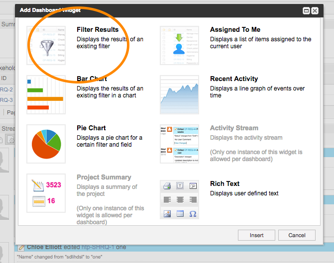

    3. We are going to go to the Dashboard and click on "Add Widget". Double click on the "Filter Results" widget and then add in your Advanced filter we just made.

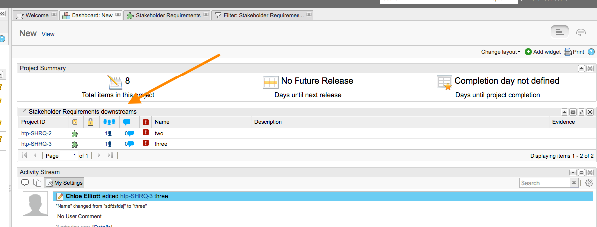

    4. Look in your Dashboard:

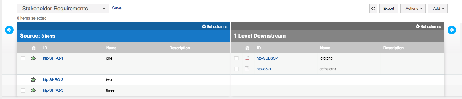

    Here are my two Requirements which do not have any downstream items to the two items specified, as evidenced from this Traceview:
    You end up with a targeted requirement to-do list.
