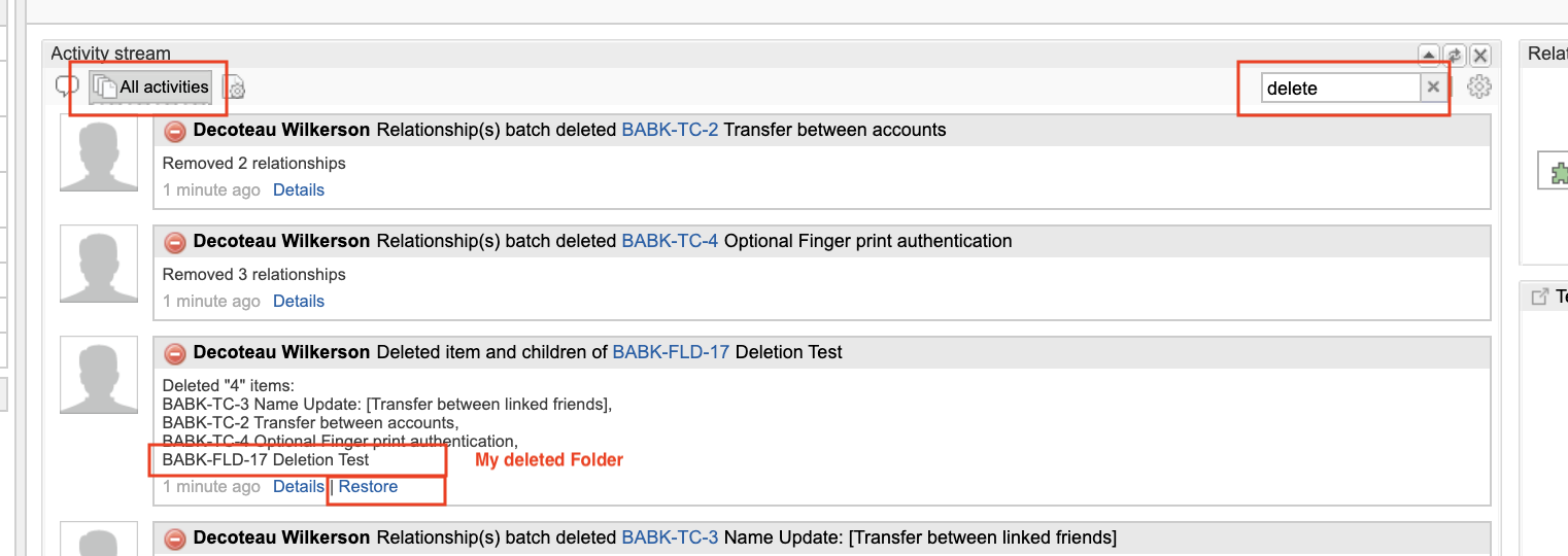

    Thanks for reaching out! You should be able to Restore the deleted folder using your Project Activity Stream widget. This widget is located on your Project's Dashboard. Since someone else deleted the folder, you'll want to select "All Activities" tab, and then search for "delete" and scroll until you find the desired folder.
    Restoring this folder will restore the Test Cases it contains (along with the item's relationships and associated Test Runs.)

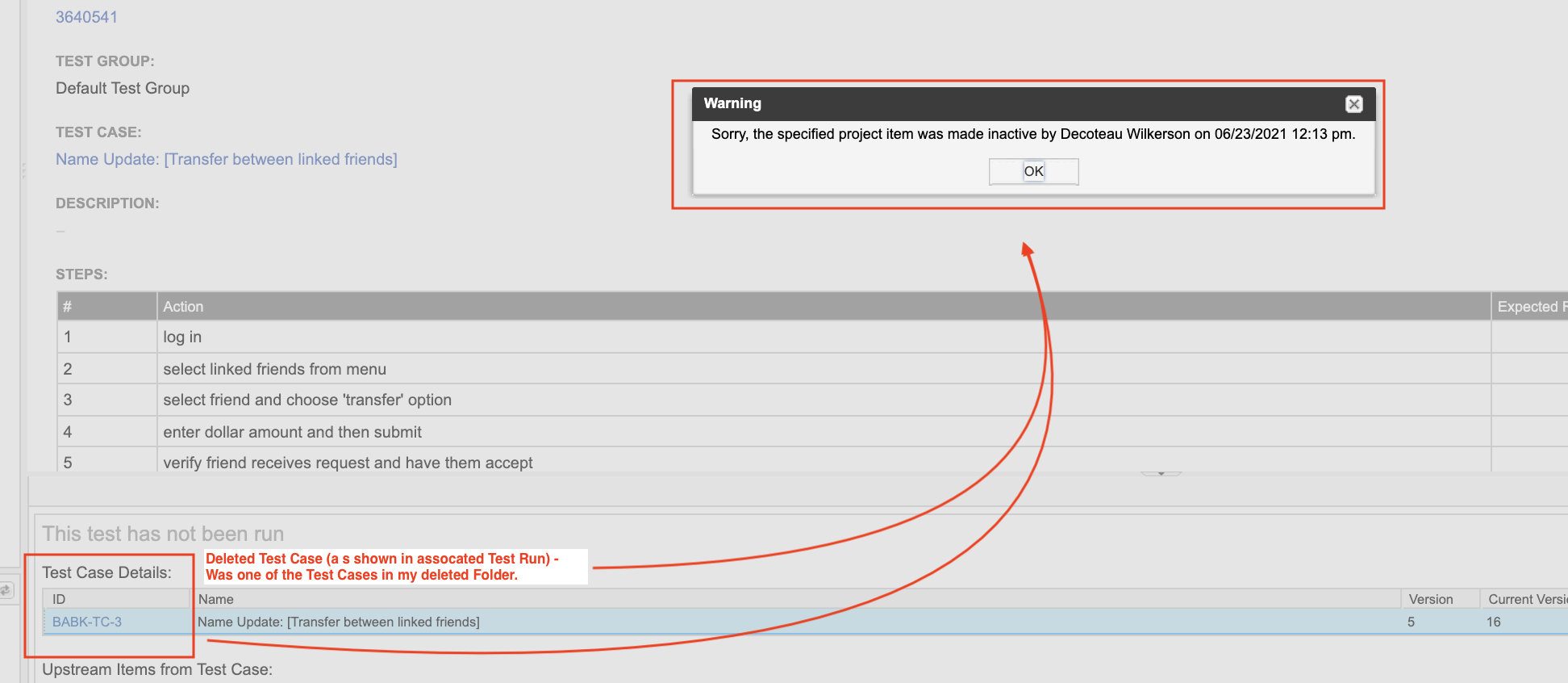

    Please ask the user if they searched in the Project Dashboard Activity Stream widget with the "All Activities" tab selected. Example:
    Please note, the system uses the terminology "made inactive" in the pop-up when you try to access deleted items. Example:
    However, searching for "delete" in the Activity Stream will search for that term as the action.
    Please ask the user to confirm that they have searched using "All Activities" and that they are using through all of the results.

    1: I would need to see more specific information in your instance to verify whether the "made inactive" pop-up was incorrect. Can you share screenshots of the "inactive" pop-up message and of the deletion notes made in the Activity Stream showing that a different user performed this task?
