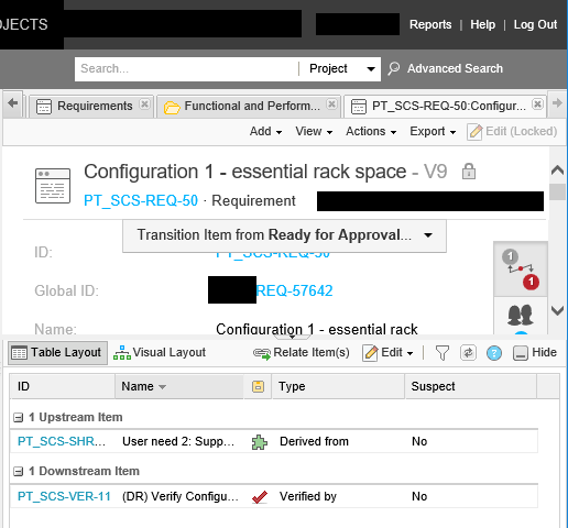

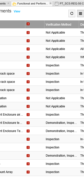

    I'm having what sounds like the same issue, although not arising from a Jira import.
    The Relationship Status column of my Requirements Set shows a Missing Downstream flag against each requirement (see top screenshot). A randomly selected requirement, when opened, shows 1 up (grey) /1 down (red) on the Relationship Status Indicator, and lists both upstream and downstream items in the Relationships pane (see bottom screenshot).
    Only the Requirements with "not applicable" in the Verification Method column should show no downstream relationships (they contain design guidance or definitions referred to elsewhere in the Set).
    There are no Suspect Links in the project.
    Screenshot showing Relationship Status column of requirements set.
    Screenshot showing Relationship Status Indicator and related items.
    Edited to add screenshot showing mouseover text:
    Screenshot showing mouseover text in list view.
  • 4.  RE: Relationship Status: Missing Downstream Orphan Item
    Posted 07-12-2018 21:54
    I eventually solved the problem by tweaking the relationship rules. What I thought were parallel downstream items were actually both required in order to clear the flag.
