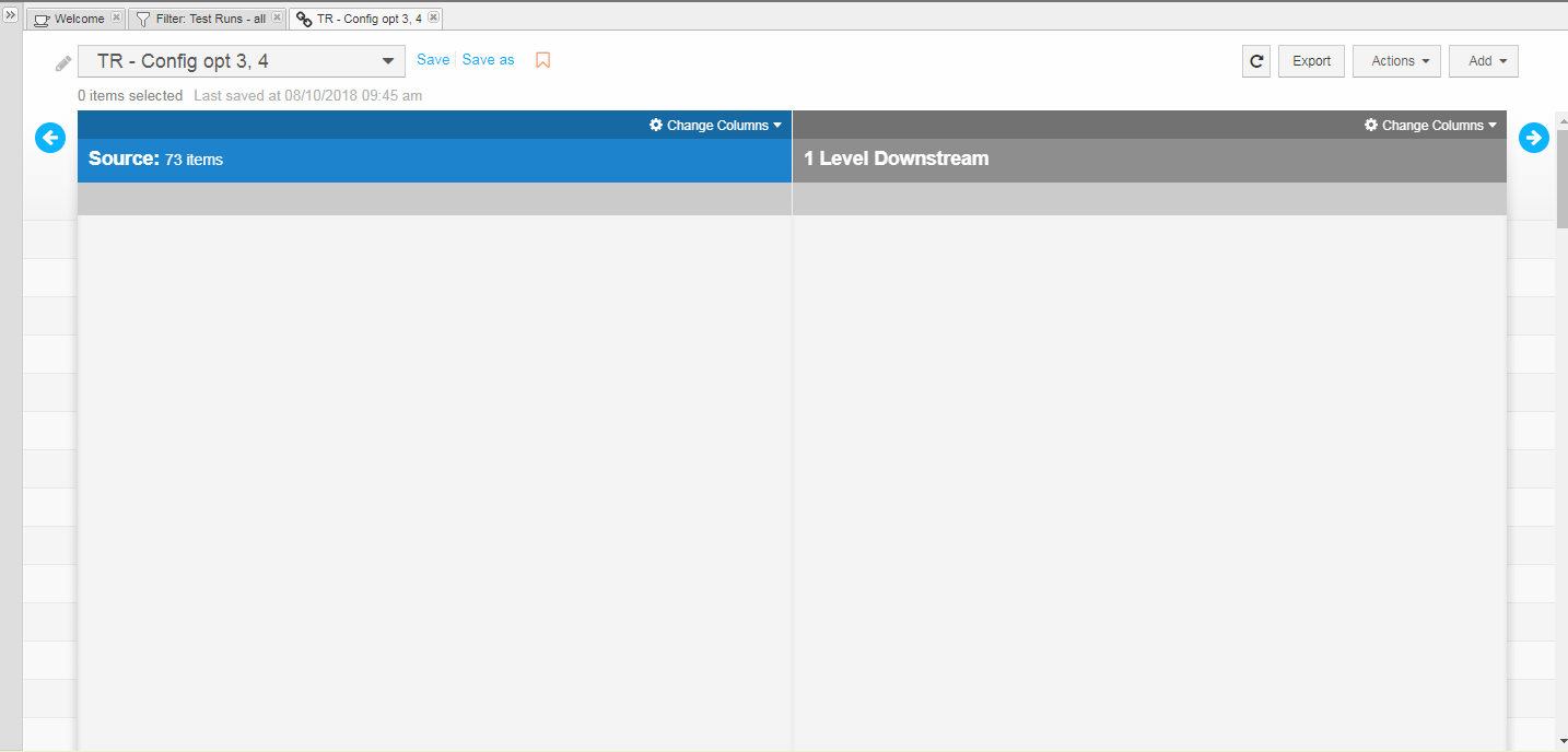

    I'm using 8.25 and I've noticed some odd behavior in Trace View. Sometimes when I select a saved view the list is blank:
    Blank Trace View
    The column heading "Source" says there are 73 items - where are they?

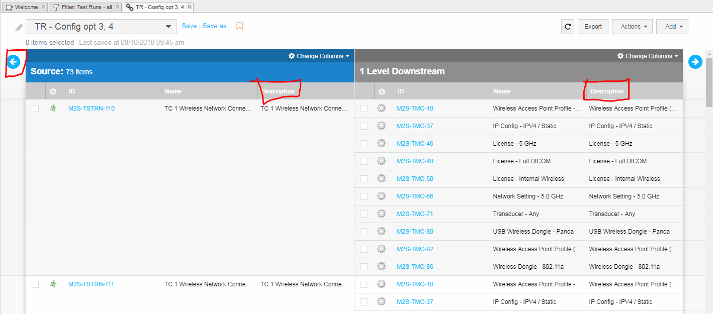

    If I refresh the screen using the browser refresh or by traversing up the relationship path the data appears but the columns are the default ones and not the ones I saved with the view:
    Trace View Wrong Columns
    On the Source side a custom field should be displayed instead of Description. On the "1 Level Downstream" side Description should not be displayed.

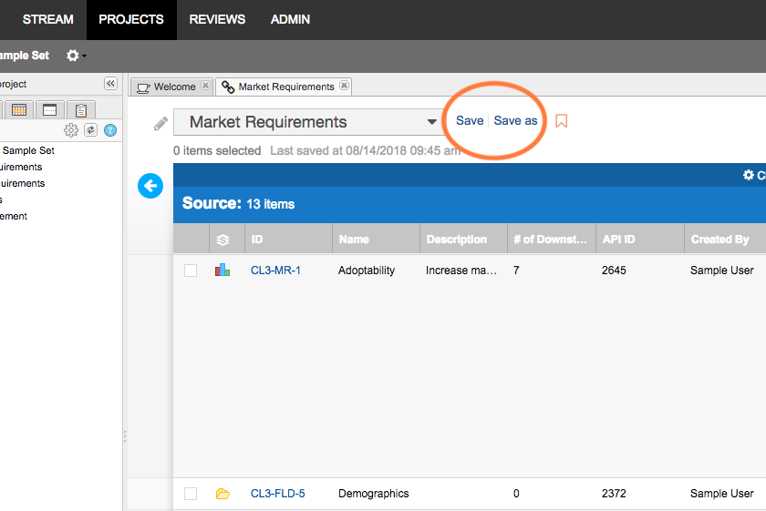

    Alright, I have been playing in Traceview and have a few more questions and possibilities. My first question is have you saved your view after you changed the fields?
    I found that before I "saved" my view I could make my settings disappear too, but only if I refreshed the whole Chrome browser. When I refreshed within Jama, my settings stayed.

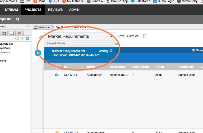

    Once you configure and save the view, you should be able to access it like so:
