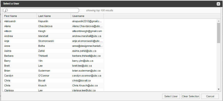

    3. If we put all the programs, pathways and courses in a single pick list there will be 2000+ entries. To help the user select from a single pick list can we configure a custom pick list widget that has a search capability much like this one?

    3. Once again...no, there is not a means to do this, either.
    The reason I mentioned the Item of Type field rather than a custom pick list is because the Item of Type custom field will be populated with whatever item type you indicate in the field configuration. This means you could theoretically have an Item of Type field in your Business Rule configured to bring up a searchable list of Learning Opportunities, meaning users wouldn't have to scroll through 2000 program and course values. However, that does require you to put all the Learning Opportunities in Jama itself as items (but you could do that via REST).

    Hi Chris,
    The Item of Type field doesn't have a search box. I mixed up my fields when I was thinking this problem through. It will display 500 items at a time, though, and the browser search function will work on the modal. Not ideal, but if it benefits you to have Learning Opportunities actually in Jama vs. just as pick list values, it'd be better than a multi-select. Sorry for leading you astray.
