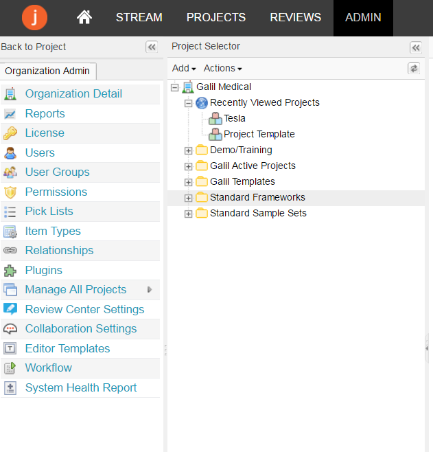

    Yes - I attempted to delete the project and it does not appear in the ADMIN area of the Manage All Projects section (image below). A second user was not involved in the delete process as this occurred during a meeting presentation with the guidance of our trainer - Erin.
    Are there any issues here or should we consider the email a false positive?

    Yes, at this time I would disregard the email. If any deletion issues come up please contact support@jamasoftware.com
