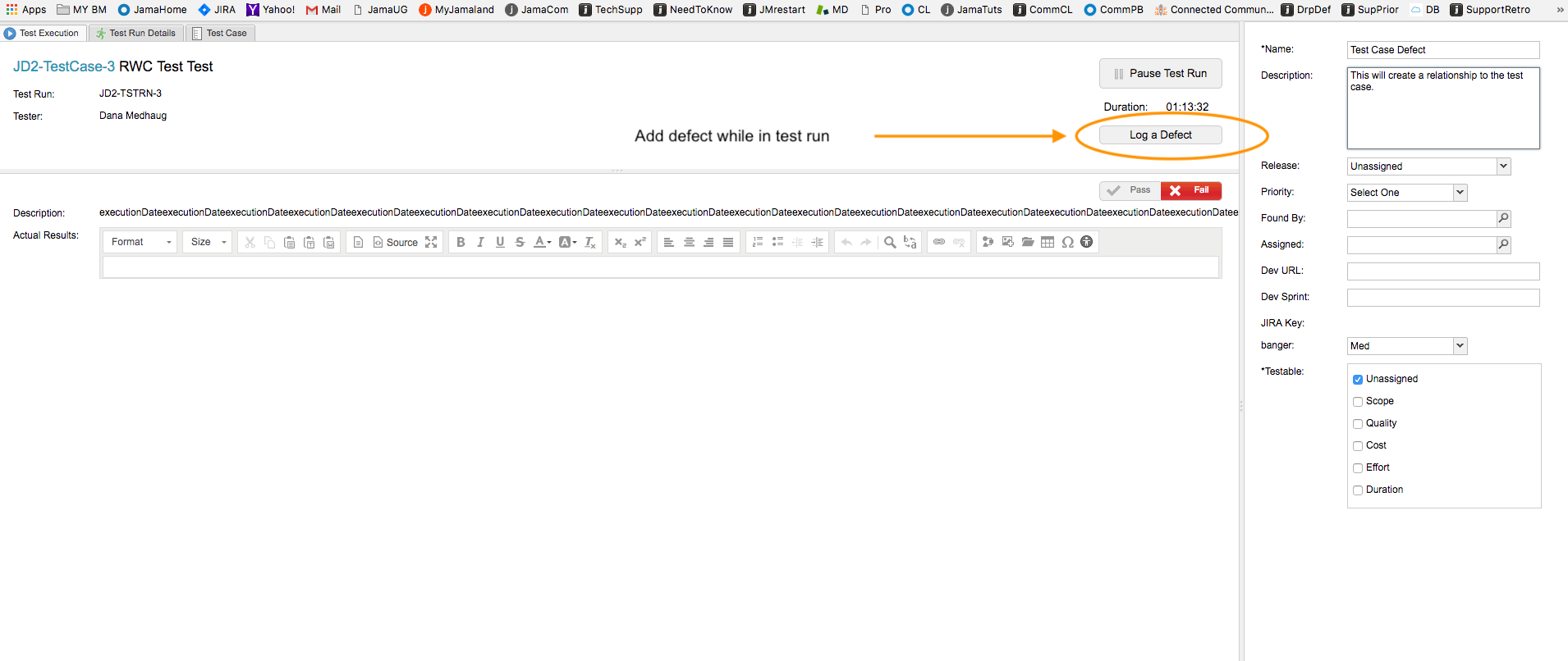

    Hello Dilusha,
    You can relate a defect to a test case while you are in the Test Run window. You would need to set up a destination for the Test Run Defects to be sent to. Which is done by navigating to Configure Project > Settings. I added a couple screenshots in case you needed some visual assistance.
    Dana Medhaug

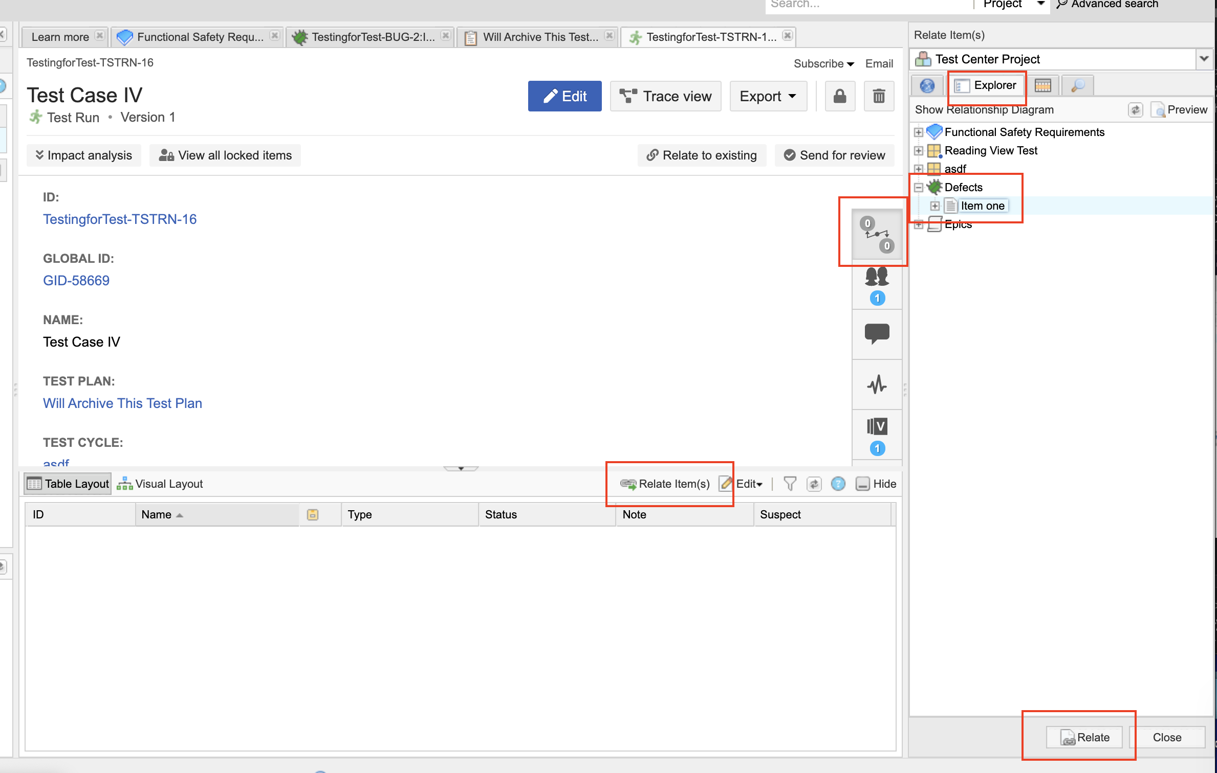

    Hi Albert,
    You should be able to relate your Test Run to an existing Defect.
    Please open the Test Run in Single Item View (SIV) and select the Relationships widget. From there, you should be able to select Relate Items and select an existing Defect in the right-hand side Relate Items pop-up window. Example:
    Can you let me know if that works?

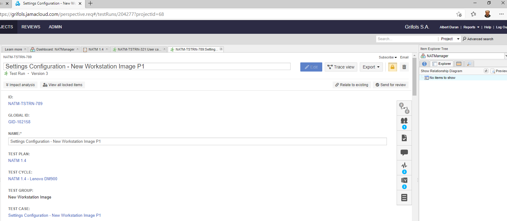

  • 5.  RE: Link Defect ID to Failed Test Case
    Posted 29 days ago
    Edited by Albert 28 days ago

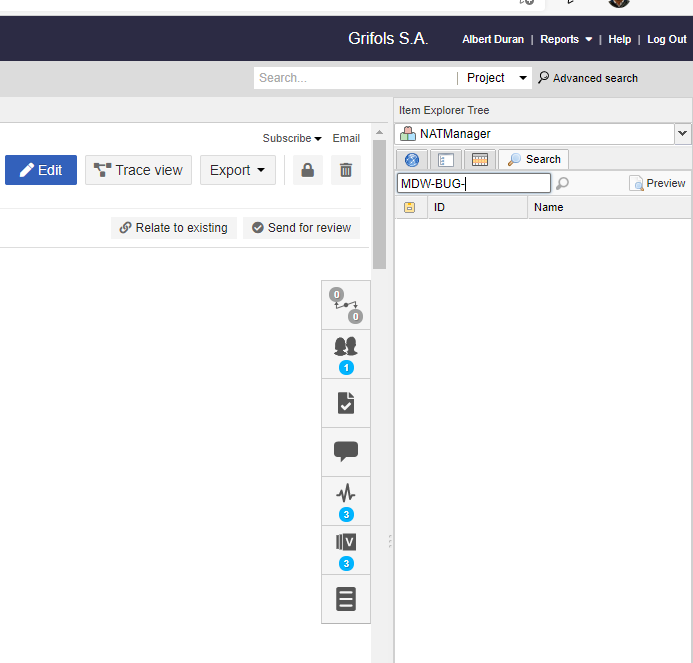

    Hi Decoteau,
    Thanks for your reply.
    When I try to relate a run with an existing anomaly, I can't see any of the existing anomalies in the system (there're plenty of them)
    I also tried to use the search tab but the anomalies doesn't show either.
    May I have a missing configuration?
    Thank you very much,
    Albert Duran
  • 6.  RE: Link Defect ID to Failed Test Case
    Posted 28 days ago
    Hi Albert,
    Do you have relationships configured between these item types? You can refer to this User Guide page on Managing Relationship Rules for more information on where to find this setup.
  • 7.  RE: Link Defect ID to Failed Test Case
    Posted 28 days ago
    Hi Decoteau,
    many thanks for your reply, I can't see the Organization section on the setup by following the guide.
    I guess that I don't have permissions for it, I will ask for them to my IT Admin.
    In the relationships chart I'm not able to see the Test Runs, so clearly the problem is that there's no relation between both item types.
    I will try to get this relationship and will tell you something about how it worked.
    Thank you very much for your support.
    Albert Duran
