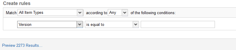

    we have tried to filter items by version number, but it doesn't work as we thought.
    I have not found any information online on how to use the version filter correctly.
    Many items with many versions exist:
    How can we filter items by a specific item version?

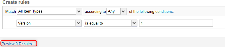

    Thank you for reaching out! It looks like you've encountered a known defect:

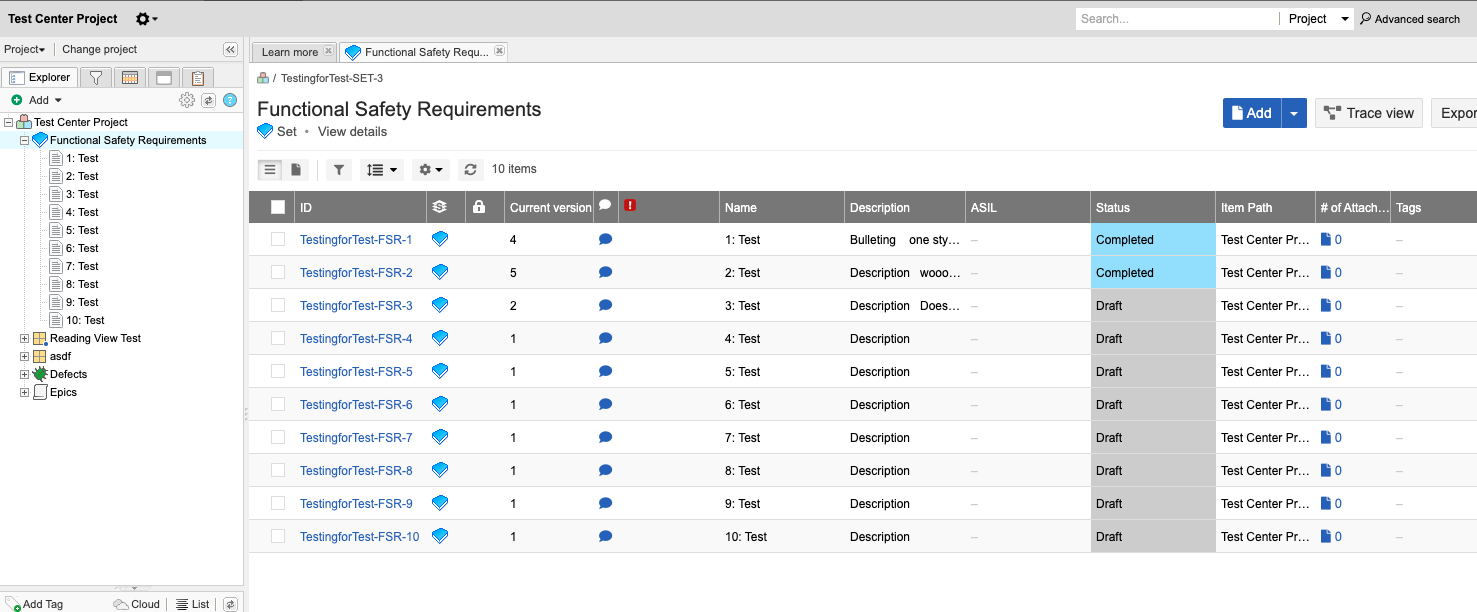

    SOS-DEF-5201 - Filter/Search: Using the Current Version field, as a rule, yields 0 results. There is no official workaround. However, I got around this by viewing my set of items in List View and then dragged the "Current Version" column to the left to make it more visible. You can then sort by the version number by clicking the header for that column.
