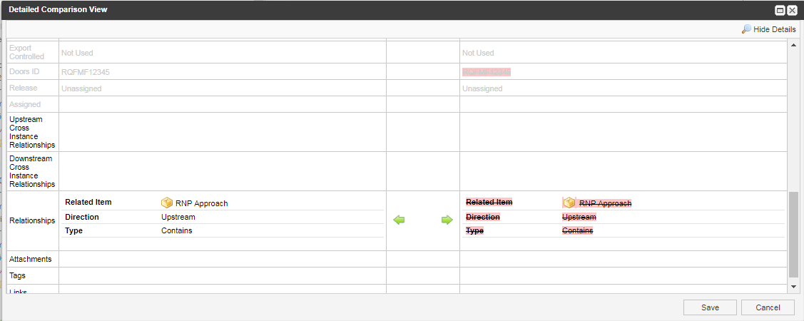

    When I hit the "Out of Sync" indication, I show the "Detailed Comparison View", which tells me what flags are causing the "Out of Sync" indication. As you can see in the below picture, "Relationships" are not grayed out while other fields such as "Doors ID" is grayed out. Therefore, the two items are shown "Out of Sync" not because of differences in "Doors ID" but due to differences in "Relationships". I would like for these two items show as "Out of Sync" only if their "Description" changes.
    Flags for Sync Indicator
    Please advise if you need further clarification on this.

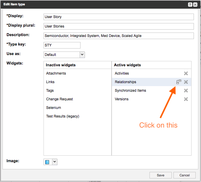

    Thanks for linking that video, if you look at 3:50, it shows you how to go into the Admin > Item Types > (go to item) > Edit > Active Widgets > Relationships (click the toggle button: see picture below) > Save settings
    This button appears to be exactly what you are looking for, the Relationships are still there but being inSync is not affected by it's status. Good find, let me know if this works for you!

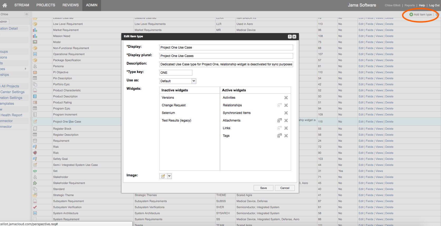

    I have an idea but, I do not know how feasible it is for you. I am thinking that you could make a project-dedicated custom item type which has all the configurations you need but, no one except your project actually utilizes. Admin > Item Types > Add Item Type Here is an example:
    You could grandfather this item type in, depends on what your workflow looks like with older information. Or you could possibly do a project wide conversion of the old item type into the newly created one? See here in the User Guide: Convert an item to another item.

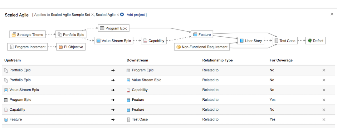

    2. The project level relationship rules will need to be reconfigured to include the new item type. Example of Relationship Rules Diagram below:
