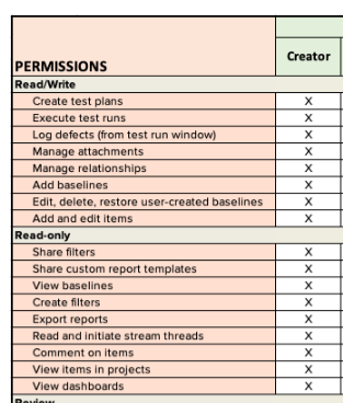

    There is a diagram that I've found very helpful - Permissions by License Type.
    This breaks down most of what you seem to be asking for. From what I can tell, it would seem that the actions you've details would need Read/Write permissions but please let me know if I am missing anything.

    What Florian and I were focusing on is the Permissions for the Creator License.
    The fact is, there are the differences between the given documentation and what I have in our instance.
    In the documentation, it is said - Creator needs Read/Write Permission to Execute Test runs and Log defects( from Test run windows).
    In my test, I see the Creators needs only Read Permission to Execute Test runs and Log defects (from Test run windows).

    Thank you for clarifying. Yes, I can verify through testing that a user with a Creator license and Read-Only permissions to a Project can Execute Test Runs and Log Defects (from that window.)
    I believe the intent behind that graph was to show how those actions may be more restricted with other non-Creator licenses. However, it could be made more clear that Creator licenses have those additional abilities.
    I will file a request to add this note to our User Guide.
