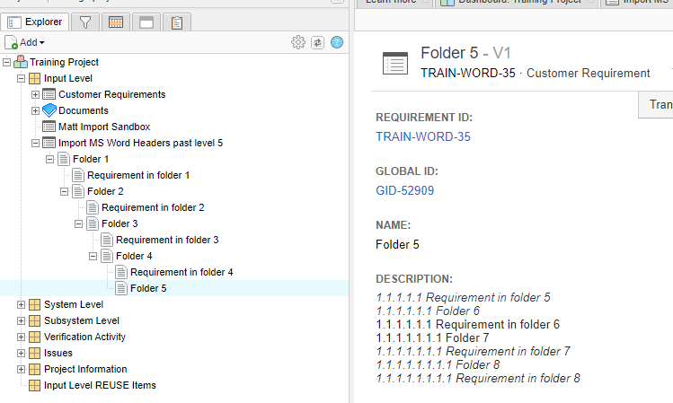

    Looks like this particular instance is hanging up on level "heading 6" MS Word heading style. Attached is the Word document we were using as an experiment to see how deep we could import.
    The results are looking like this, with the deepest level just getting everything deeper than it shoved in:
    Regardless of if it's level 6 or 7, we often times have specifications that can go as far as "heading 12" deep.
    If there were a way to tweak that setting during the Import Wizard or on a per component/set basis, that could be a nice feature.
    We will use the work around of creating "sub-documents" to import for levels deeper than "heading 7", as there does not appear to be a maximum number of levels one could create manually.
    Seems like the "heading 7" limit is related to importing functionality, and not a limit on the number of levels deep (e.g. we've been able to import an additional 7 layers from the 7th layer, creating 14 nested layers)

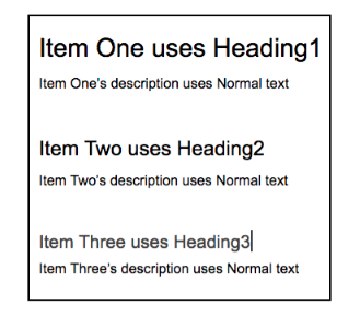

    Thank you for providing this doc! I tried recreating the issue with your doc and also noticed that it imported 5 layers. Then, I tried these same steps using a new Word doc. In that new doc, I followed the Heading styles outlined in our User Guide:
    By following those Heading styles, I was able to import 6 levels (but not 7) so I reached out to our Product team for assistance.
    They let me know that, due to scalability, it has been deemed as "by design" that importing, via the Heading style shown above, will allow up to 6 levels. I've submitted a documentation request to have this updated in our User Guide.
    Can you try reformatting your document to follow the Heading style noted above and let me know if you're able to import 6 levels?
