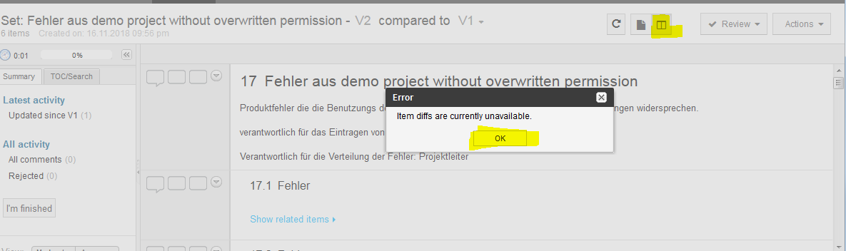

    In review center, the compare view prompts error such in screenshot. When I click Ok, the compare view just shows me the different in Name, Status and Heading.
    It could not highlight the changes in description field.

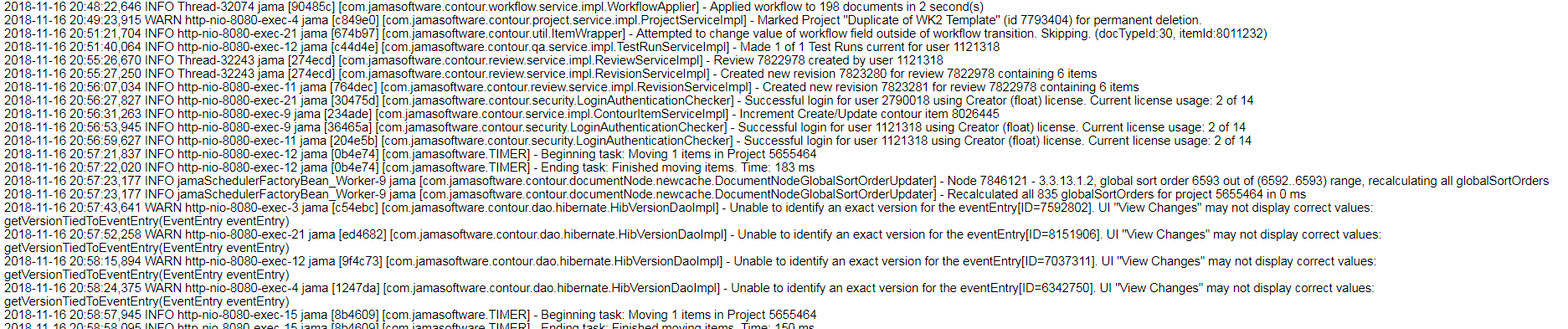

    In logging under Root I see this

    Looks like this is a current bug (ID: SOS-DEF-2415) in the Review Center: If you edit a Review and publish a new revision, an error occurs when you select compare view.
    The workaround is to click "OK" on the error and select "compare view" again.
    This bug is logged in our internal system and I can see that your org is already related to that bug. You can check future release notes for this ID to see if this bug has been fixed.
