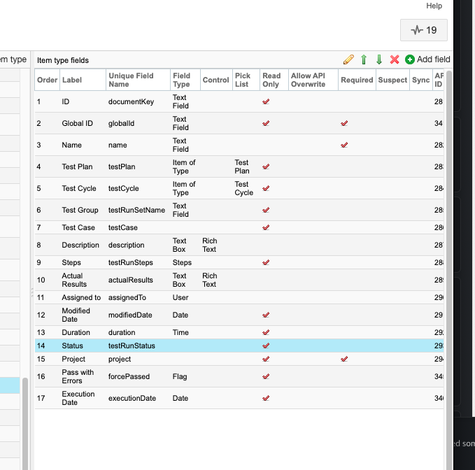

    Let me make sure we're discussing the same details. I may have misunderstood your inquiry as I was referring to not being able to apply a Workflow to your Test Run here in Admin > Workflow (example)
    However, it sounds like you're referring to a Workflow field that's been configured to your Test Run. I haven't come across a Workflow Status field being a default field and double-checked the fields in my own Test Run and didn't see it there.
    (Example below shows Test Run Status but not Workflow.)
    Is there a chance that an Org Admin added that as a custom field to the Test Run in your instance?

    Hi Jason,
    From what I understand, it would appear that the field you're seeing is a custom one and not a default configuration. Also, I do not know of any changes planned to change the way Test Run item types behave. However, I hope we can still find a workaround for your current ask.
