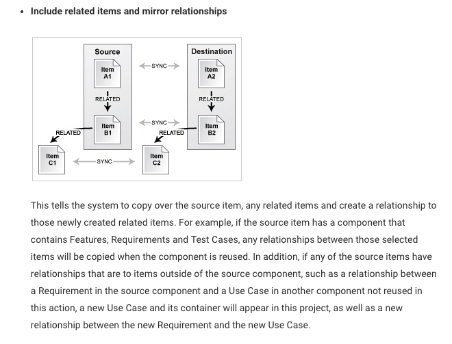

    Hi there, I am thinking that you used the Reuse functionality to make these copies? If so, do you recall which setting was used, was it:
    1.) Include relationships from the source selection:
    or 2.) Include related items and mirror relationships:
    If you did option 1, I would not recommend deleting the related item because both Project A and Project B are related to the same item. Deleting it in this scenario would ultimately just delete the item entirely from your instance.
    If you did option B, you made copies of both the Project A items and the related items. This option sync's the related items between the two projects as well so, as a precaution I would manually un-sync them and then delete the unwanted related item in your Project B.
    You can always restore a deleted item from your Activity Stream widget.
