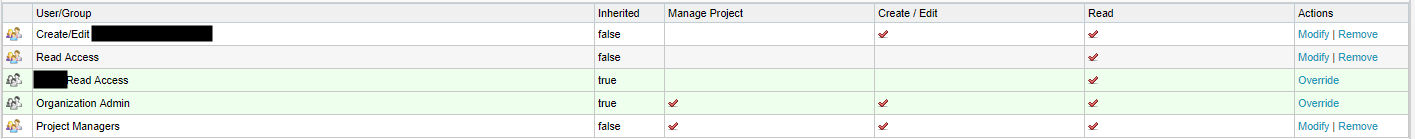

    Hi Chloe,
    thank you a lot for your advice - I already checked that and the user is in the read access group and the create/edit group of the project.
    How can I (or him/her) check the read access?
    These are the groups in the project and the user is in both Create/edit and read acess groups.
    He came in the project when it was already ongoing, so is it possible that e.g. if one item has been deleted (which is in the review), he cannot access it?
    But than again: how can I see this and how to fix this?
    Thank you a lot!
