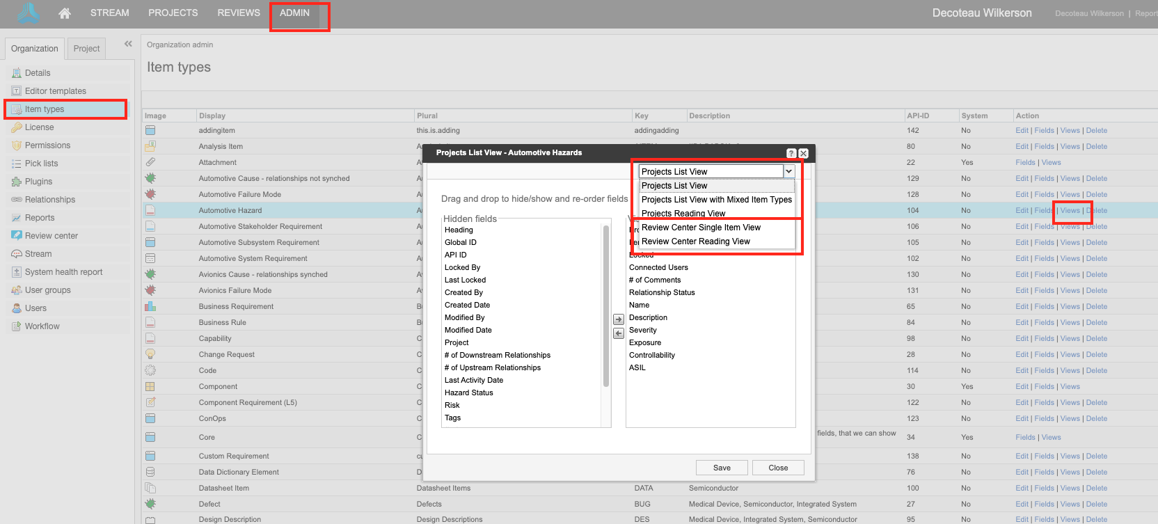

    You'll want to make sure that this new field is added as a visible field for the Review view in question.
    Please navigate to Admin > Item Types > (choose Item Type) > Views
    From there, you can add Description to the Visible Fields for either/both of the Review Center views available.
    Example:
