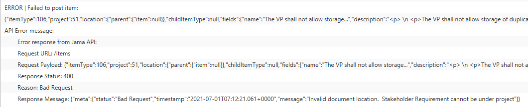

    P.S. As a test, we attempted to re-import our exported requirements back into JAMA, and get the following error from the Data Exchange tool;
    As you can see, the "parent" & "item" is null, which I believe is unexpected.

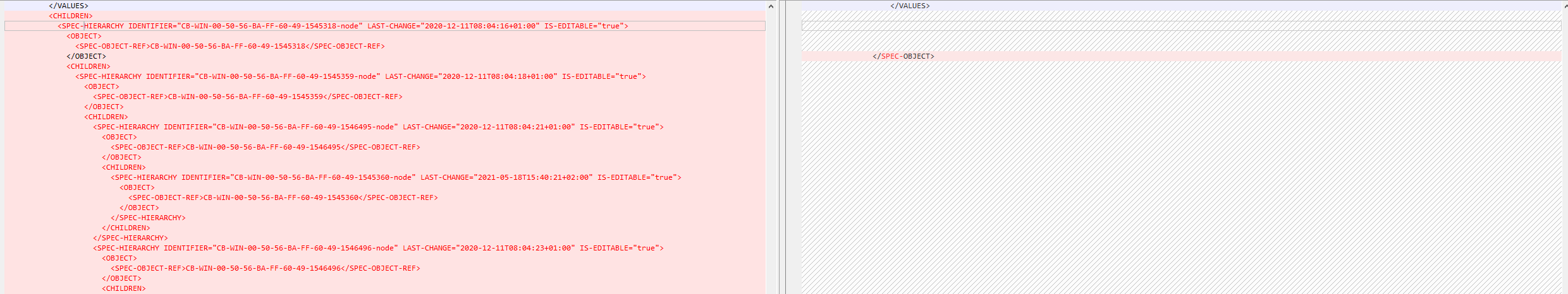

    Vendor's ReqIF shows the HIERARCHY, while the export one from Data Exchange does not. (Vendor ReqIF on Left, Exported on Right)
