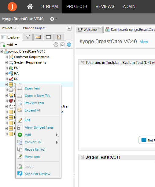

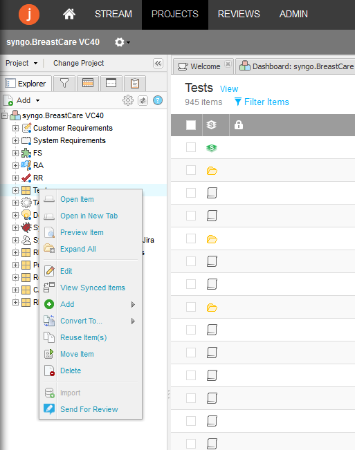

    The option to delete is simply not available when right-clicking on a set or item. I have attached two images showing what it looks like for me as a user with adminsitrative privileges - with setting enabled and disabled.
    Allow Non-Administrators To Delete Items/Containers: No
    Allow Non-Administrators To Delete Items/Containers: Yes
    The effect via the Actions menu of an item is the same - the "Delete" option is there or not.
    I am not aware of any other possibilites to delete items.
    Anna

    Hi Anna,
    Thanks for responding to my questions and providing screenshots. Since I cannot reproduce this, I am curious if there are some permissions issues at hand here. When you look at Admin > Permissions, is the syngo.BreastCare project nested under any folders? If the folder has permissions overridden for specific groups, and you belong to groups other than Org Admin, it could cause this issue, for instance.
    At any rate, if you could share your permissions with me we can go from there. If nothing is obvious to you, though, we may have to pivot this issue to a ticket and dig deeper into it, as this is not a universal issue.

  • 6.  RE: "Allow Non-Administrators To Delete Items/Containers" not working as expected
    Posted 03-01-2017 01:14
    the organization admins have the "Administrator" privilege on the organization level - and it's being inherited downwards.
    Ekaterina has opened a ticket now, because I don't want to share our permissions in the forum publicly, as the screenshot would contain project names and so on.
    Thank you,
    Anna
    Anna Henke
    MeVis BreastCare GmbH & Co. KG
  • 7.  RE: "Allow Non-Administrators To Delete Items/Containers" not working as expected
    Posted 03-01-2017 10:04
    Good plan. Thanks!
