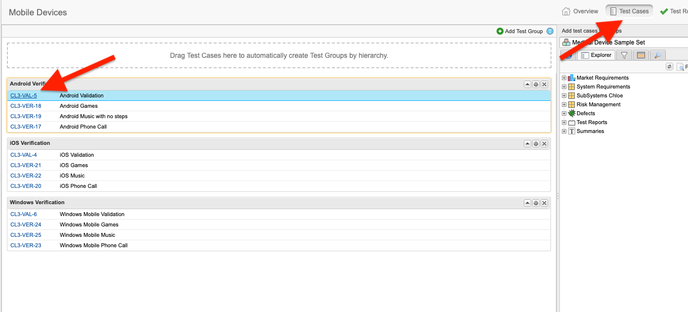

    Also, you can go into the Test Plan, click on Test Cases and click into the individual test case:
    Once in the Test Case you can see the version as well as convert to past versions using the Versioning tool.

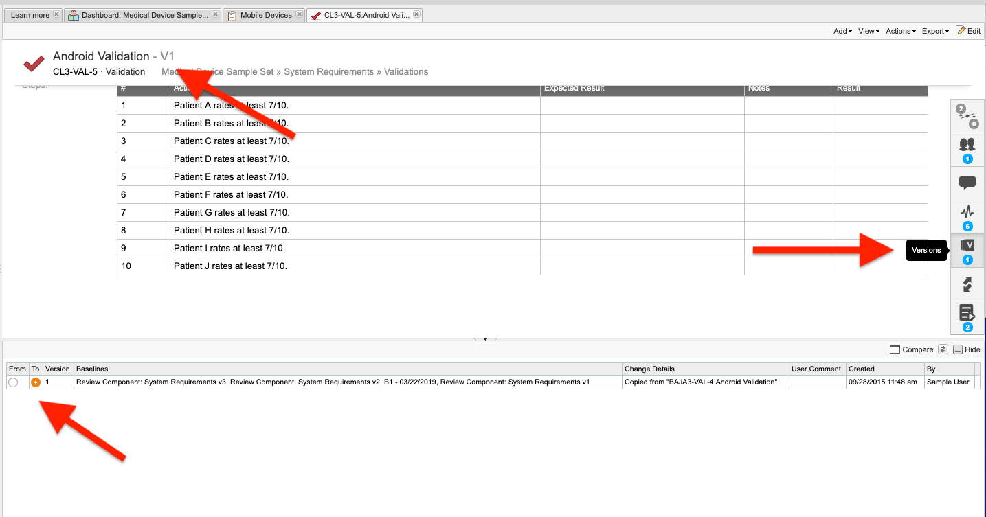

    From the Explorer Tree you should be able to go into the Test Case item, edit and save and it will make another version. From there you can decide which version to "make current" like so:
  • 6.  RE: Not able to change to various versions of Test Cases
    Posted 07-08-2019 17:01
    Ah hah! Thank you. I see that I was looking at the test case within a test run and wasn't looking at the Actual test case. So turns out within the run you can't use the versions option but within the test case you can.
