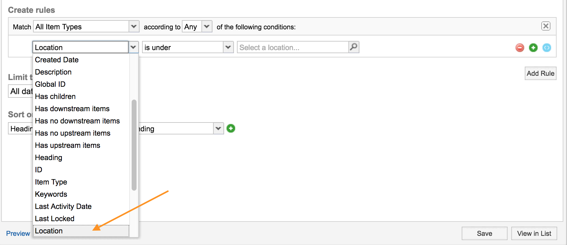

    ​So, I'll respond to my own question, because after searching quite some time, I finally stumbled across the answer:
    Use condition field should called "Location" (near the bottom of the list).
    (Pretty obvious, once you finally figure it out, but it had me stumped forever.)

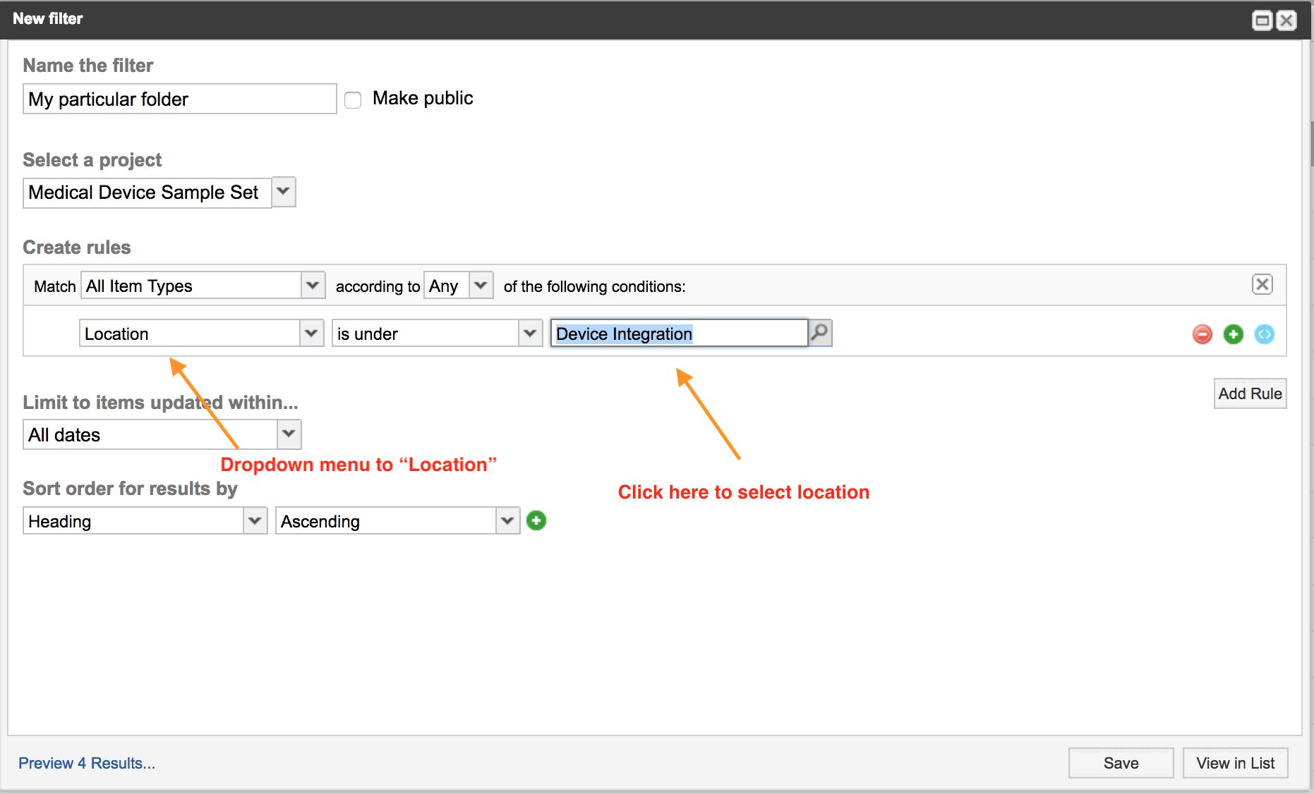

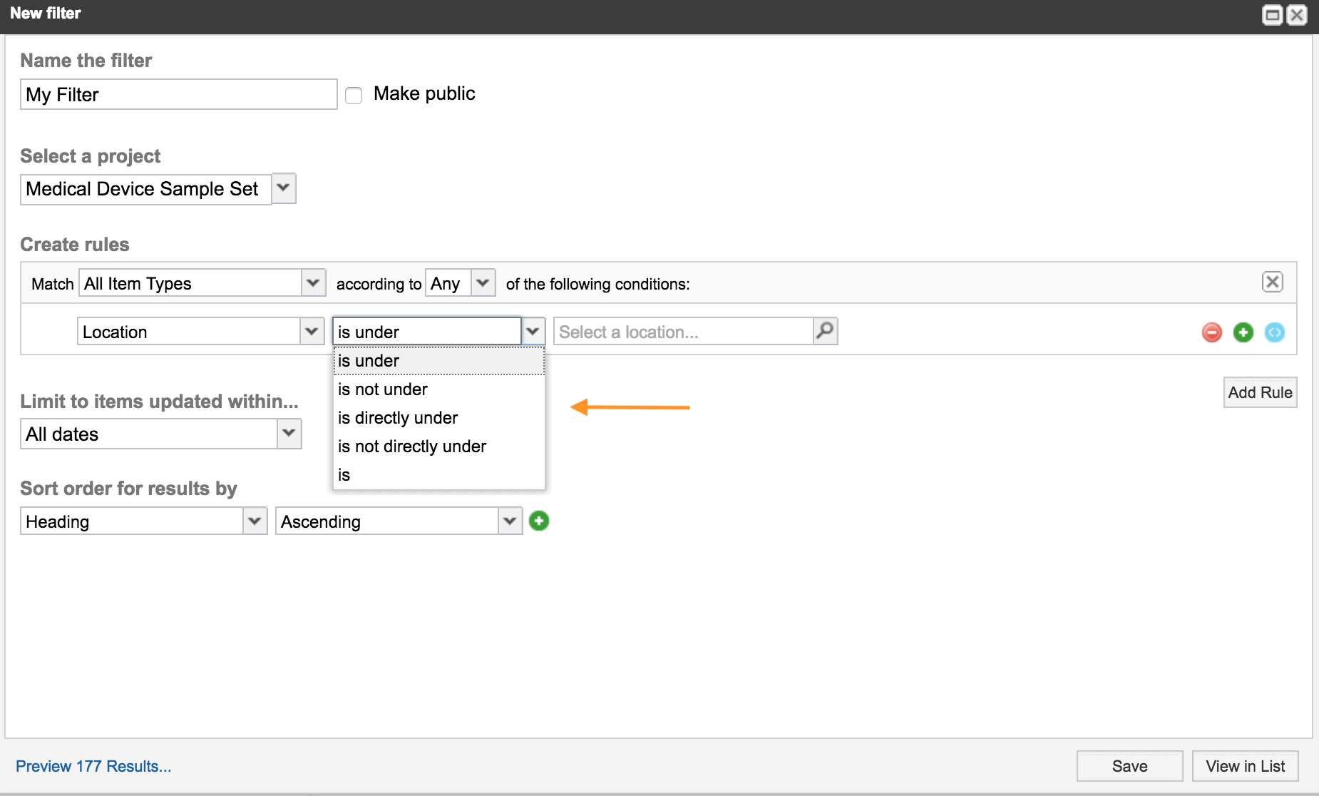

    I just want to add some visuals for anyone else in the Community who might have a similar need. When creating rules with an Advanced Filter you can find location here:
    Add a condition:
    Now we have to map our location:

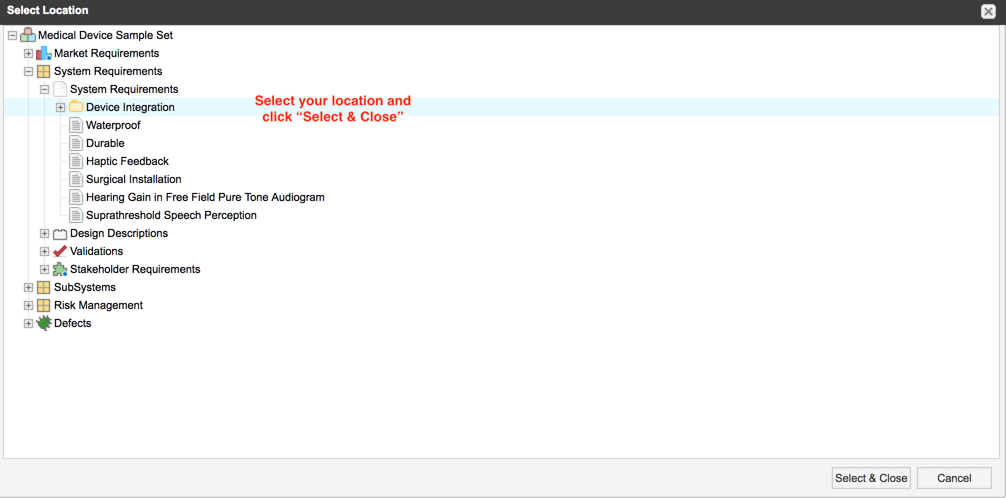

    Select a Location dropdown takes you here to look at the project map:
