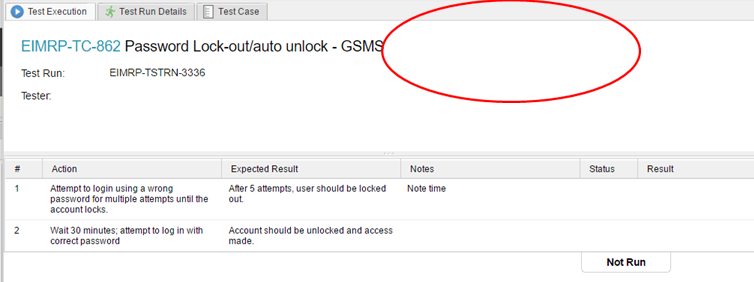

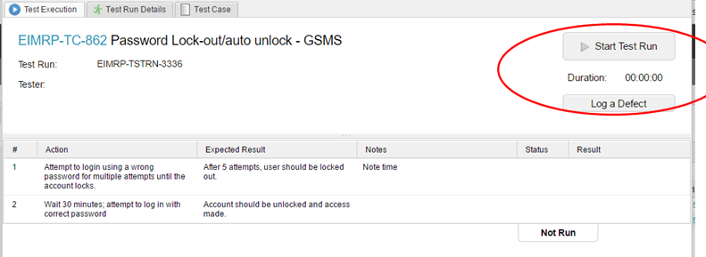

    Hello, not sure if this has been reported before but I'm unable to find discussion of it. I have a user who, when clicking on the button to execute a test run gets the pop-up screen to start the run, but the "Start a Run" button is missing.  He closes and reopens several times and then it will finally show up.  Any ideas what could be causing this?
    When first going in:
    After several times closing and reopening window:

    Hi Kristina, This user uses Chrome and has his browser set to 90%.  I asked him to do what you suggested to test things out and here are the findings:
    • Stayed with Chrome as browser and again ran into issues when zoom was set to 90%.
    • Message on the browser console:
      • perspective.req:34 [Deprecation] Synchronous XMLHttpRequest on the main thread is deprecated because of its detrimental effects to the end user's experience. For more help, check https://xhr.spec.whatwg.org/.
    • Interestingly, when the window was resized to permit view of the console, the start button appeared. Tried this half a dozen times and it worked each time.
    • Then set zoom to 100% and didn't have any issue with the start run button displaying.
    • Also tested it in IE 11 and didn't experience any issues, so it seems to be localized to Chrome when the zoom is different than 100%.
