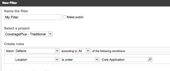

    Did you check out the above link to the user guide, which includes descriptions of available widgets? You would want to use a Filter widget.
    For the filter itself, you would want to choose Issue item type and set a Location as the Application component in question:
    filter with location selected
    If this doesn't help, let me know what problem specifically you are encountering. Thanks!

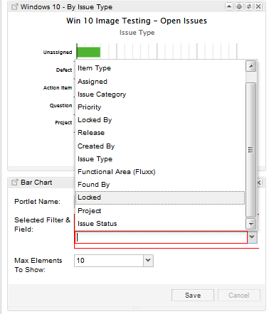

    Please let me know how to add an item to the 'field' drop-down while creating a widget
    Creating widget with the help of filter
    Gayatri

    The widget will display only fields that currently exist on the item type(s) that are returned in your filter. Is the field type you need on these item types already?

    We have a customized field called application in the issues widget and users fill it with the application name to which the issue belongs to. We want to create a widget to track the number of issues raised for each application. We have created a filter and tried to add widget by selecting the "application" field from the filter. But, we are not able to see that field available in the drop down. We tried to edit item types and checked if it appears in the drop down but not succeeded. Please suggest if it is possible to add a custom field in the widget drop down.

    If the Filter is set up to return items of a single item type, you can make visible any of the item fields. If the filter is set to return more than one item type, you will not be able to make custom fields visible in the widget.

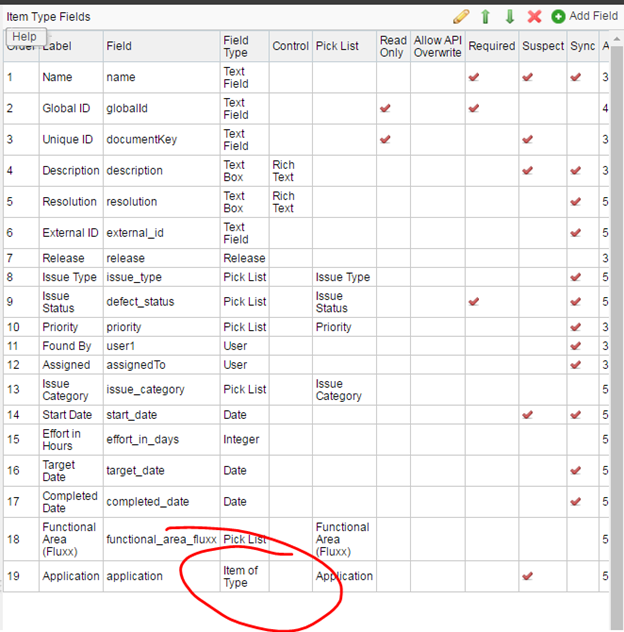

    The Applications is being used as Item of Type on a different item type (Issues).
    So we are trying to create a widget that displays Issues by Application.  Application is a custom item type that is being used as an Item of Type field on the Issues item.
    Gayatri

    Hi Gayatri,
    Sorry we have been going back and forth for so long on this. The problem here is that the use of "Item of Type" field is not supported in the Bar Chart widget: it can only display pick list and default fields. (The "Item of Type" is a custom field type that is somewhere in between the two kinds of fields.)
