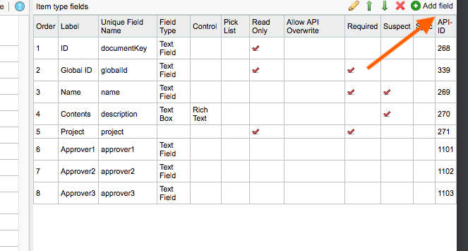

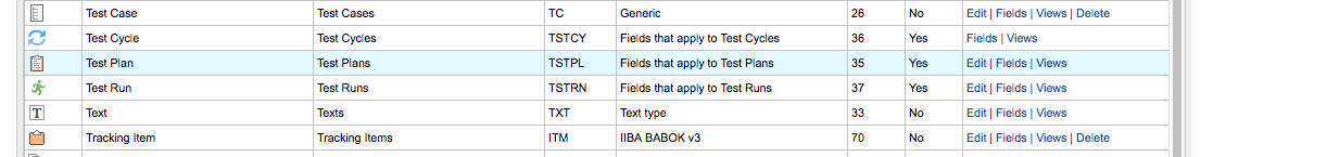

    Good to hear from you again. You can certainly add more Text Fields to the Test Plan item-type and get this result:
    You just need to go in the Admin Panel > Item types > Test Plan item type > Fields:

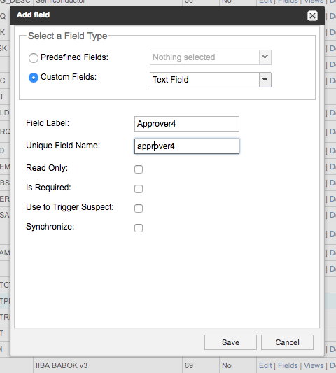

    Add Field:
    And then this window will pop up:

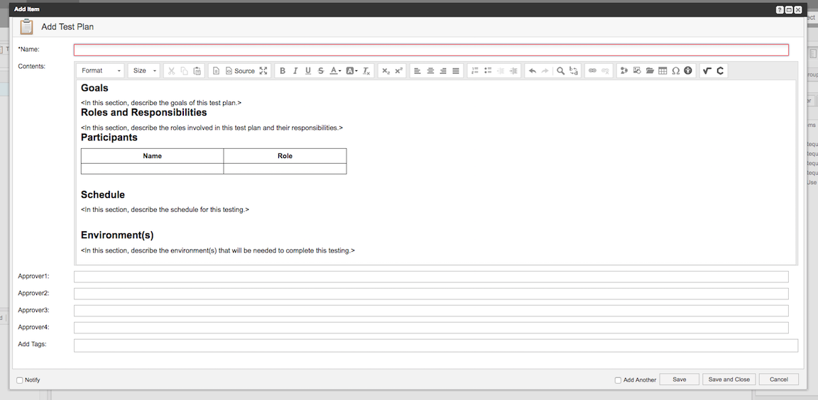

    I chose to make a "Custom Field" that is a "Text Field" but if you know who the group of Approvers are, you could make a Custom Pick List...
    I added this field type four times and named them: Approver1, Approver2, Approver3, Approver4.
