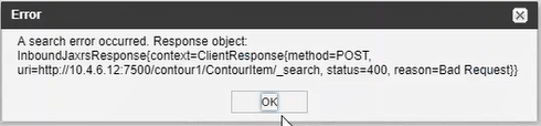

    I have one user who is experiencing some weird behavior.  This User logs in to Jama, go to the Project Test Plans, selects a active test plan and then clicks on the Test Run tab.  Normally this would return the list of all the test runs for that cycle and Test plan but instead the browser returns the attached error message.
    Error Message Bad Request
    The user is located out of the country (on the other side of the globe) so i can't walk or drive out to the Users location and sit down to look over the browser setting.  The error doesn't show up in the log viewer so no help there.  Is there another log or can i up the logging level of one of the logs to capture this information?
    Does anyone have suggestion on how to pin point the users issue?

    The User did provide a video to show the issue.  It shows the events in this order;
    1. The User logs into Jama
    2. The User clicks on the Project with the issue in the Recently Viewed list
    3. The User clicks Test Plans tabs
    3. The User clicks on one of the test plans in the list.
    4.  They User clicks on the Test Runs tab in the upper right corner and the error message pops up within 5 seconds.
    The error message only appears when the User tries to access the Test Runs for any Test Plan for that Project.  They have a Collaborator license and have read access to the project.
    The User is using Chrome for the Browser but is in Incognito mode.  I asked for try accessing the test runs when not in incognito mode but they have reported getting the same error message.

    I had a chance to schedule a time with the users that where having the access issue so they could walk through the process that is giving them the error while i had the "advance" logging turned on.  I then created a support bundle, downloaded it and then looked over everything that was captured during the testing time.  What i found was when the user was experiencing the issue, in the jamaseach.log i saw a search error.
    13:10:02.462 [elasticsearch[Black Jack Tarr][transport_client_worker][T#7]{New I/O worker #7}] WARN org.elasticsearch.transport - [Black Jack Tarr] Transport response handler not found of id [2608595]
    13:10:02.466 [qtp371397455-19479] WARN c.j.s.s.p.resource.SearchResource - search by object: index: jama, ndexrestype: ContourItem, exception: A search error occurred.
    Caused by: java.lang.Exception: execution exception during phase "query": RemoteTransportException[[Conquest][10.4.6.12:9300][indices:data/read/search[phase/query]]]; nested: QueryPhaseExecutionException[Result window is too large, from + size must be less than or equal to: [1000000] but was [5000000]. See the scroll api for a more efficient way to request large data sets. This limit can be set by changing the [index.max_result_window] index level parameter.];
    at com.jamasoftware.service.search.provider.SearchException.<init>(SearchException.java:9) ~[classes!/:2.2.3]
    Could this be a possible cause for the 400 Bad Request my User (now two Users) are getting when trying to pull up Test Runs?

    I know this is a old post but while i was working on another issue i stumbled on the fix for this issue and wanted to share this with the community.
    The short of the issue was the user typed in a huge value (5000000) for the "Show" amount instead of staying with one of the normal values in the pick list (20, 50, 100, 200, 500). Once the user typed in the large number, the page would return theInboundJaxrsResponse - 400 Bad Request error and they could not change it.  To fix the issue i had make changes in the database.  The query to find the offending users was something like;
    select * from propertyentry where propertyname = "jama.user.gridConfig" and propertyvalue like '%"listPageSize":5000000%';
    I changed the "listPageSize" values to 500 and the user was able to see Test Runs again.
