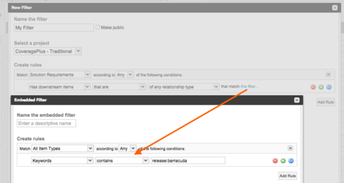

    However, as a workaround, you can search
    for releases among projects by searching for Keywords that contain "release:releasename" Example below:
    So you can add a Keyword search for the release in addition to your set of items. If needed, you could also apply additional conditional statements: How to Use Conditional Statements in Advanced Filters
