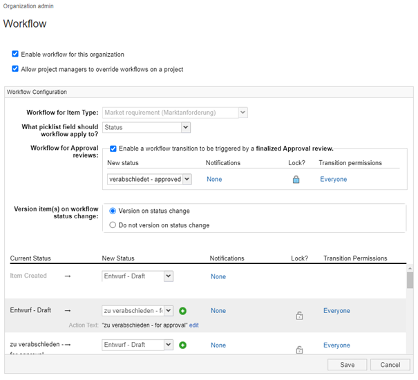

    Description:
    with activated "Workflow for Approval reviews", overridden Workflow configured at the project level can not be saved, when the user only has the Project Administration right.
    Preconditions:
    Workflow for Approval review is configured, as every one can change status to approved with finalize a review
    User has only Project Administration right.
    Steps to reproduce:
    User, as a Project Manager for a single project, navigates to the Admin> his project.
    Unser Project admin> Workflow, he chooses to override the workflow from an item.
    Permission Error was shown and "new Status" was empty
    User click Ok. He can edit the Transition.
    Try to save.
    It can not be save since the new Status is empty.
    At the project level, the option "Workflow for Approval Review" is read only.

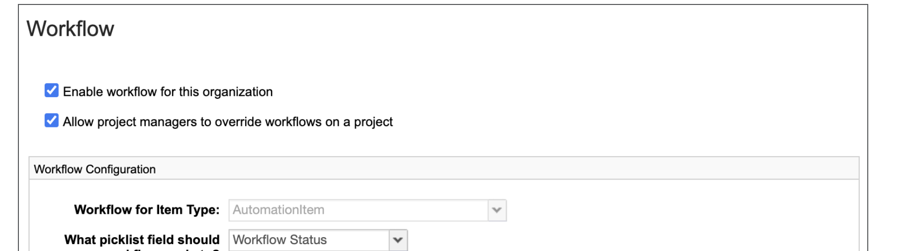

    Hi Lien,
    Thanks for reaching out! For some reason, your images did not come through on my end.
    Can you confirm that you've selected the option to allow Project Admins to override workflows on a project? As shown below.

    Hi Decoteau,
    Yes, the option to allow project Admins to override workflows is selected.

    Hi Decoteau,
    just want to make sure we are on the same page.
    The Workflow for Approval Reviews can only be configured with Organisation admin. That is not the issue I want to mention here.
    The issue is the Project Administration could not override the Workflow Transition for sein project, if the organization Admin activates the "Workflow for approval reviews" for the item type.
    It was also not our intention to enable Project Administration to alter the Review workflow rules.
    From the screenshot I have shared, the behavior looks more like a bug,
    The Project Administration chooses to override a workflow for sein project, the configured "Workflow for approval reviews" was incorrectly shown, the value of a obligated field was empty, even though it was a read-only field.
    Please help us to review this bug
    Lien

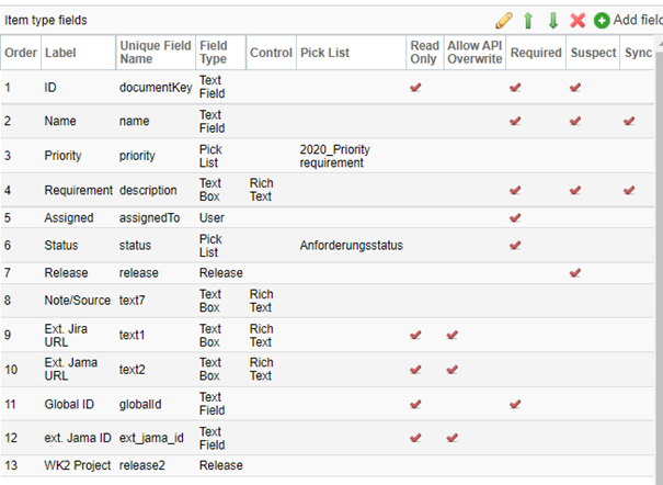

    Can you show us if that read-only field looks different in the Admin > Workflows view? Also, can you share a screenshot of how that item is built in Admin > Item Types > (Item Type) > Fields?

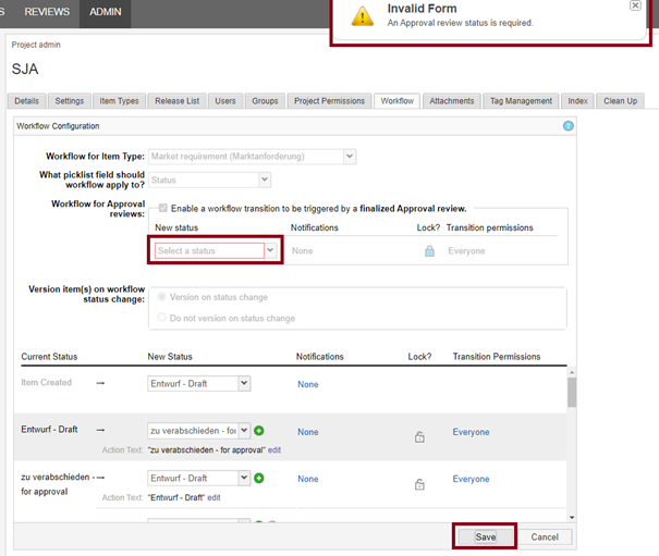

  • 7.  RE: Jama 8.62.2 - with activated "Workflow for Approval reviews" - issue by overriding Workflow at the Project level
    Posted 26 days ago
    Hi Decoteau,

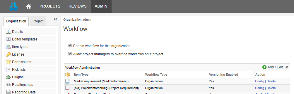

     The Workaround does not work in my case. Once the Project Admin clicks "Ok", he can alter the transition but he can not save. Once clicking Save, prompt Jama Error "Invalid Form" (as per the first screenshot)
    To compare, you find the screenshot of "Admin > Workflows" for the same item type
    As per request, I'm sending also the screenshot from Admin > Item Types > (Item Type) > Fields
    Lien Bäcker
