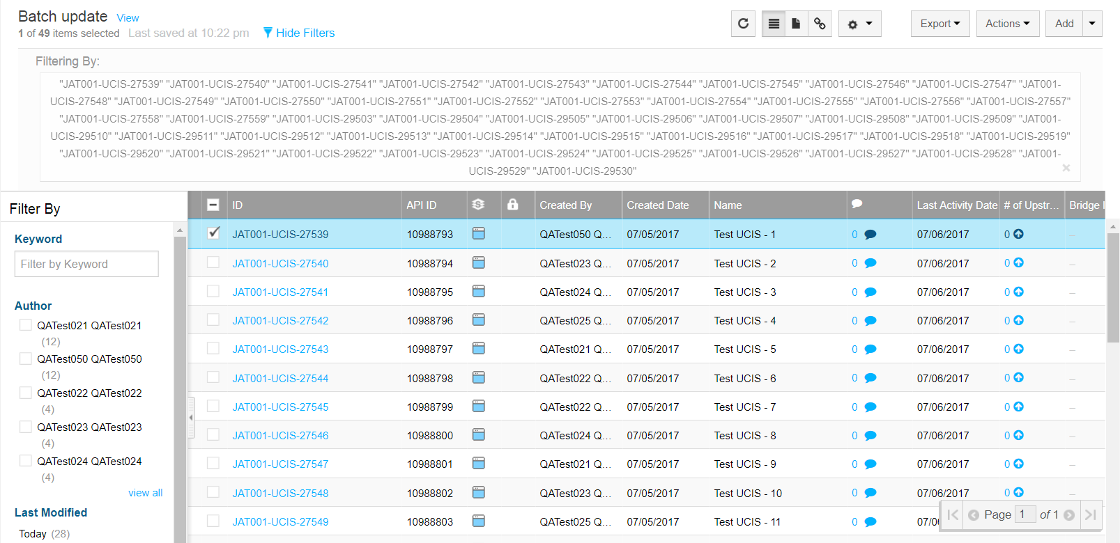

    Posted 08-21-2017 10:00
    Hello Dana,
    Jama seems to work find when we filter a small number of items, however when we filter a larger chunk of items that requires us to scroll down the list, that's when it seems to remove the scroll bar at the bottom of the page.
    Please find the screenshot attached below:
    Jama 8.14.1 - Scroll bar disappears
    Please let me know if you need more details.
    Thank you!
    Vishal R
  • 7.  RE: Scroll bar disappears after filtering
    Posted 08-21-2017 16:17
    Vishal,
    There is a known defect in Jama Software (SOS-DEF-2009) which I think may be causing this. Are you by chance using IE11? Your robust Facet Filter search paired with IE11 could be the cause of the missing scroll bar. Have you tried this in other browsers?

  • 9.  RE: Scroll bar disappears after filtering
    Posted 08-22-2017 15:49
    Hi Vishal,
    I think this is a different permutation because the Chrome issue occurs only when you put many values in the Filter by Keyword field, whereas with IE, it happens regardless. I'm looking into this and will let you know by the end of the week. It's a defect, regardless!
  • 10.  RE: Scroll bar disappears after filtering
    Best Answer
    Posted 08-23-2017 10:00
    @Vishal we decided to add the behavior you're reporting to the existing defect, saying SOS-DEF-2009 will occur in all browsers under the condition that the Filter By Keyword field is used. I noticed when reproducing the defect that I could still scroll sideways, however, no bar appeared...I hope that's the case for you. If it's not, let me know, and I'll update the bug accordingly.
  • 11.  RE: Scroll bar disappears after filtering
    Posted 08-23-2017 10:12
    Thank you!
    Yes, same here; I'm able to scroll using the keys, but it's pretty slow without the scroll bar..
    Keep us posted.
