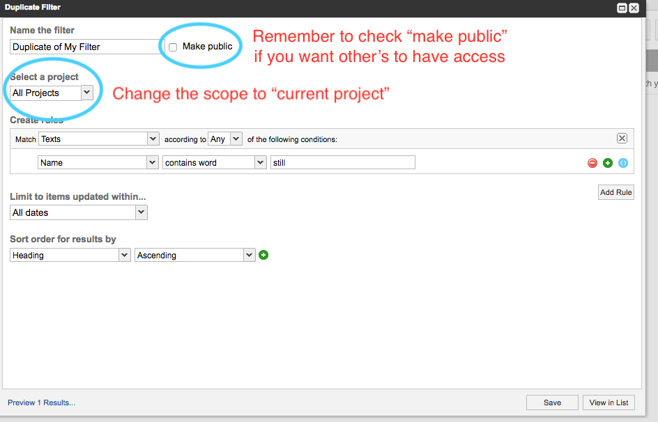

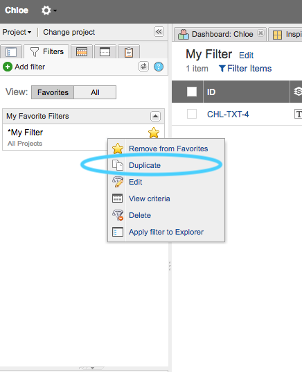

    So, this is expected behavior if you use the All Projects option. I am assuming that you need all these individual projects to use the same basic functionality filter but, you would like the ability to make "tweaks" to one filter (due to individual user-case needs) without it effecting the others? If this is so, I would go into each of the individual projects, duplicate the "defects" filter and change the scope to "Current Project".
    You can duplicate the filter by right-clicking the filter and pulling up the menu like this:
    Then change the scope from "All Projects" to "Current Project" or the name of the project. Make "public" so others can see the filter.
    Then you can make dynamic project-based changes to your "defects" filer without changing all the rest of the projects in your Explorer Tree.
