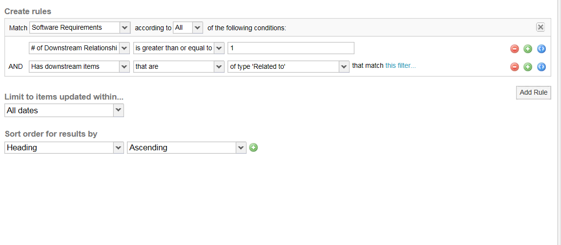

    Has anybody had any problems with filters? I need to filter on software requirements that have # of downstream items >=1 of relationship type "Related to". The filter returns only a partial list of the software requirements that meet the criteria. See a screenshot of my filter...am I doing something wrong?

    Hi Francesca,
    Welcome to the community! I'm glad you were able to (finally) log in. I have a couple of questions:
    1. What is the original scope of the filter—do you have it set to [currrent project], all projects, or a specific project?
    2. Do you have a condition in the embedded filter (the that match this filter link)

      The scope of the search is the current project, and I don't have a condition in the embedded filter.

    Just curious but if you remove the first condition do you get what you need? I don't imagine it should be any different, if it is there could be a bug, but I think the second condition already covers the first one, i.e. if you have "related to" items then you have 1 or more items related to.

    I did remove the first condition, and I got the right list, BUT I should be able to use the " # of Downstream relationships" to help me see only the items that have downstream relationships in the range I'm interested in...for example, = 1, >= 3, etc.
    If I only filter on the "# of Downstream relationships" and want only the items that have # of Downstream relationships = 2, for example, the filter returns a list with items that have 0 # of Downstream relationships!
    The "# of Downstream relationships" field does not seem to be working, as I would expect it to work.

    I agree with Ed's assessment that there could be a bug here. What version of Jama are you using? I was able to receive filter results with these conditions in my hosted environment (currently Jama 8.13, the latest), so it's definitely something that should work.

    2015.5 was released in 2015; we changed our versioning scheme in 2016 with the release of 8.1. Sorry for that confusing lore! So I just tested this in 2015.5 and it looks like a bug in that version. However, it is not present in Jama now.
