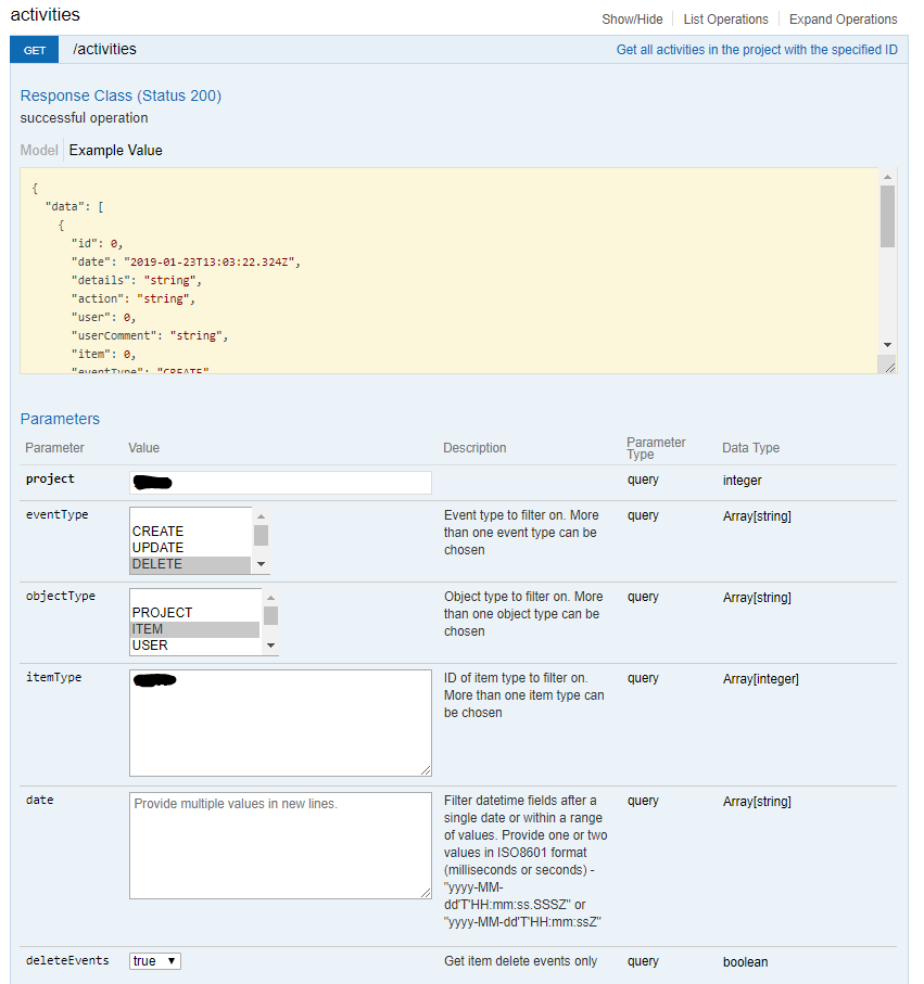

    I'm currently running a script that deletes the deleted items from JamaCloud.
    And for that i'm using Jama REST API's ("Get all activities in the project with the specified ID"):
    jamarest
    But i'm only getting data from like a month ago.
    For example i've got a requirement in my database that is supposed to get deleted by the script using your api, but when i enter the data above^ i'm only getting data from 2018-12-17 and above.

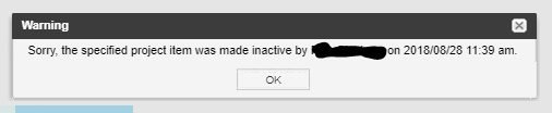

    When i try to open the requirement in Jamacloud i get the following:
    ff
    Where did that item go?

    Mussab:
    The message "Sorry, the specified project item was made inactive by KJLJ lJLJK on TIMESTAMP" means that someone deleted this item at this date. To investigate, you can go back to the timestamp in your Project Stream and see what else may have been deleted and by whom.

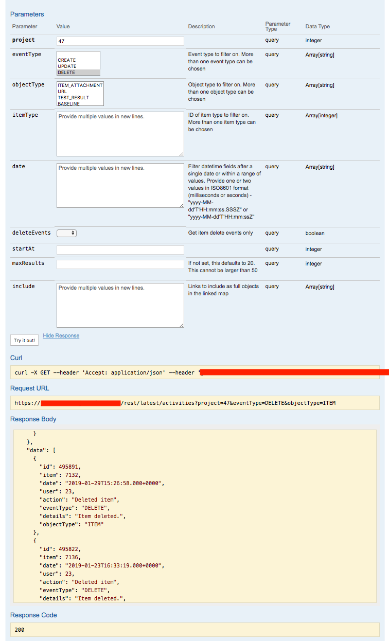

    While I was testing this myself just now, I wasn't able to process any sort of deletions through the API after an Item was removed from the UI, but I was able to find recent Deletions just by inputting only the DELETE eventType and Project ID into the /activities endpoint and I can't help but notice that it looks like you're limiting your results based on item types.
    Would you mind confirming Chloe's questions and also trying to run your GET activities call again without any sort of itemType limitation and letting me know if that helps? I've attached a screenshot of my calls to this response to try and help clarify exactly what I mean here.

    So what i am doing is visualising Jama data on a local website at my workplace. First i'm pulling the Jama data using REST and then storing it in a database. And to shorten the running time of my script i'm only pulling the new changes for the last two days and inserting them to the database, instead of deleting everything and pulling it again every day.
    And here comes the challange, when pulling the changes i'm only getting the new items, the deleted items will stay in my database. And for that i'm using the attached API to get the ID's of the deleted items from Jama and and deleting them locally on my database. So i'm not trying to delete anything from Jama, i have a read-only access.
    The API does actually work most of the time and it has been running in my script for a while now, but for some reason some of the deleted items aren't showing up using this API. I've tested it on several newly-deleted items and it worked, but like i said some of the items aren't showing up.
